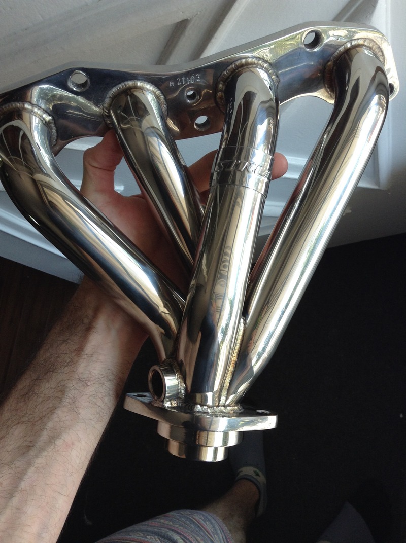

These are selling super cheap on eBay http://m.ebay.ca/itm/STRUP-4-1-EXHAU...882?nav=SEARCH
$69 + free shipping, these were originally $300!
Got mine yesterday

Old Aug 1, 2015 | 01:09 PM
domoMKIV's Avatar
Posts: 447
From: Central FL
Install it yet?
Any hardware included? Did you reuse your oem gasket?
Might order myself one of these if it works out for you.

Old Aug 1, 2015 | 04:25 PM
devmail's Avatar
Joined: Dec 2013
Posts: 898
From: Nova Scotia, Canada
I'm waiting to get another bung welded in for a wideband O2. I'll let ya know how it goes!
