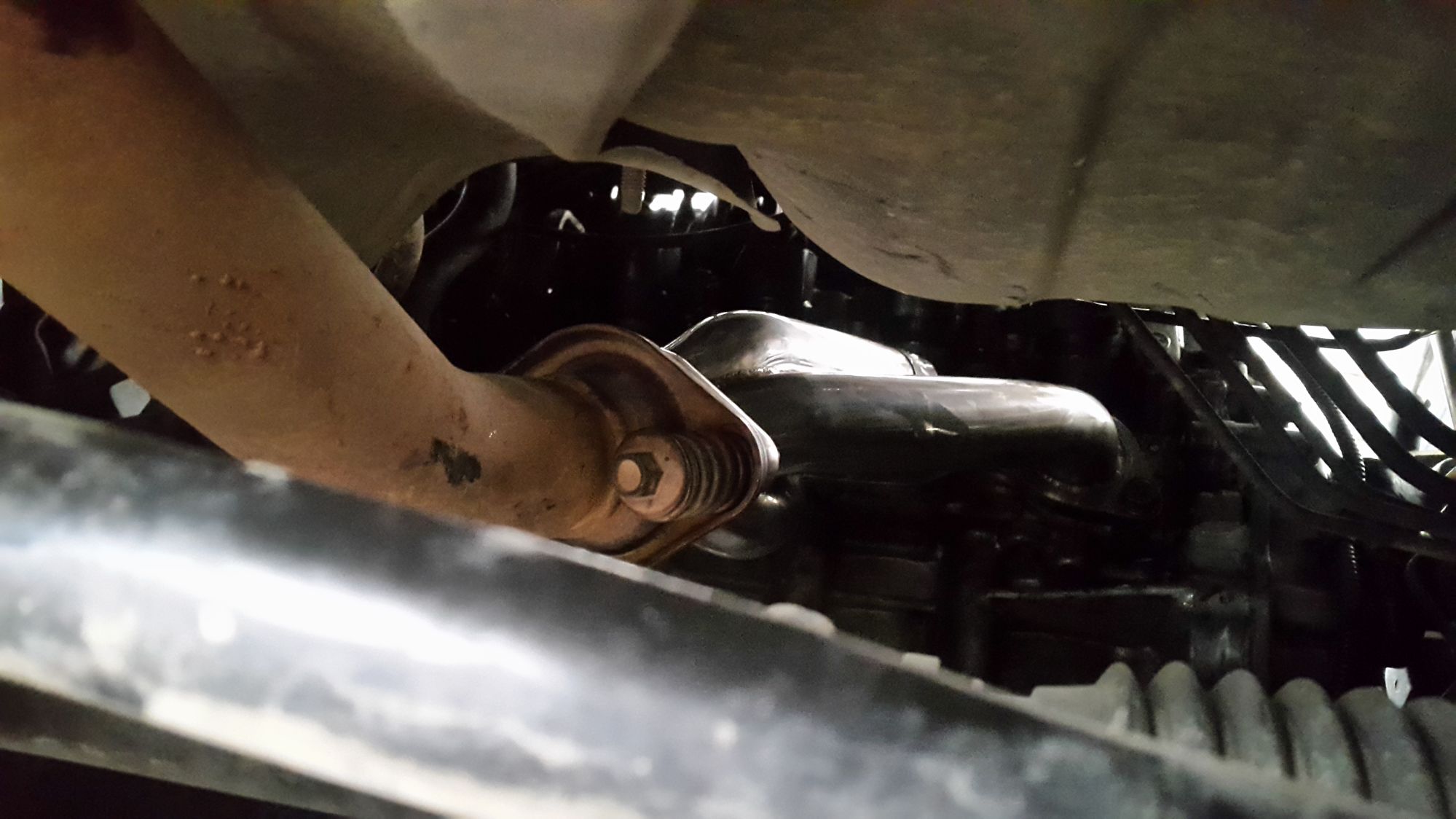

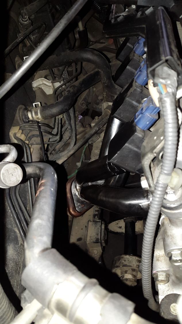

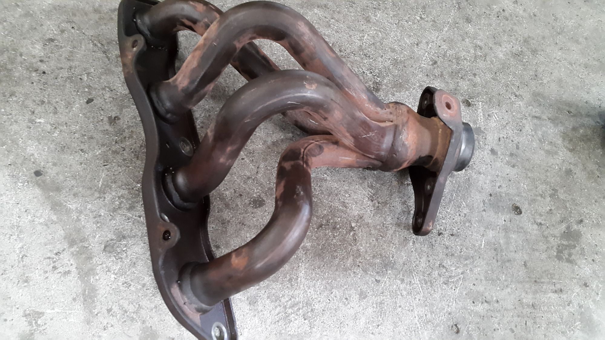

Some pictures I took that day
Originally Posted by Jimmyjoejak
Yup, it has the 3 nuts for the heat shield but the flange that accepts the spring bolts also has another hole for the bracket that mounts to the transmission. The OP said this too.
"Only weak point thus far is it doesn't have an option to mount to the stock vibration bracket at the transmission, although it doesn't seem to affect it, I'm sure other headers remove that as well."
I'm just wondering if omitting this will cause any long term problems since now the header is only held by the header bolts and the connection to the cat.
Oh yeah. But I forgot to mention one big thingy: I'm overseas and is slightly different so no bracket from start
Not sure if helps
Old one is different. No O2 sensor here. Down in the cat

Hey h8rsama,
Can I ask where you're located? From your pics it looks like the stock headers have the mounting hole but your car doesn't have the bracket.
Hey h8rsama,
Im in Colombia, and so far i know My car comes from Brazil/japan and it looks like EDM JDM
Old Jan 8, 2016 | 01:20 PM
Jimmyjoejak's Avatar
Joined: Dec 2015
Posts: 25
Yeah. Looks like the JDM cars might not use the bracket. I wonder why the USDM have it?

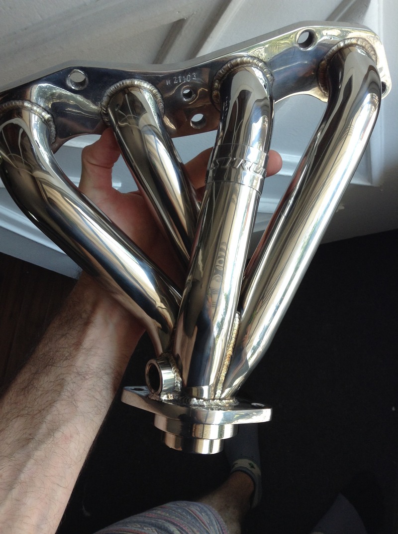

Originally Posted by devmail
These are selling super cheap on eBay STRUP 4-1 EXHAUST HEADER STAINLESS STEEL 2007-2008 HONDA FIT H21103 FOR RACING
$69 + free shipping, these were originally $300!
Got mine yesterday
Man....this thing is just a thing of beauty. Really!
