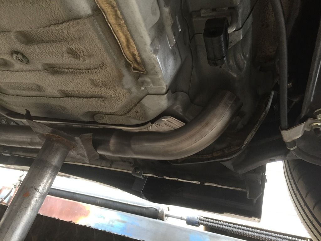

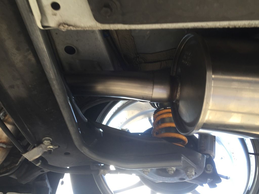

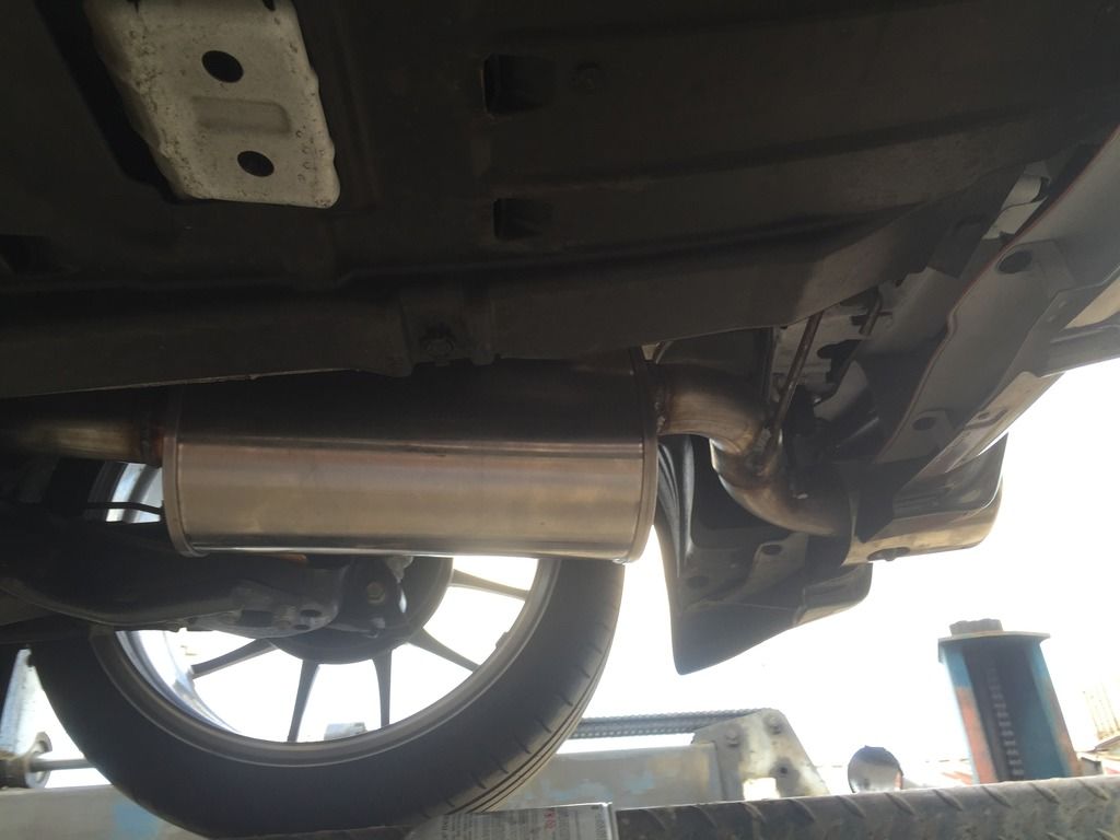

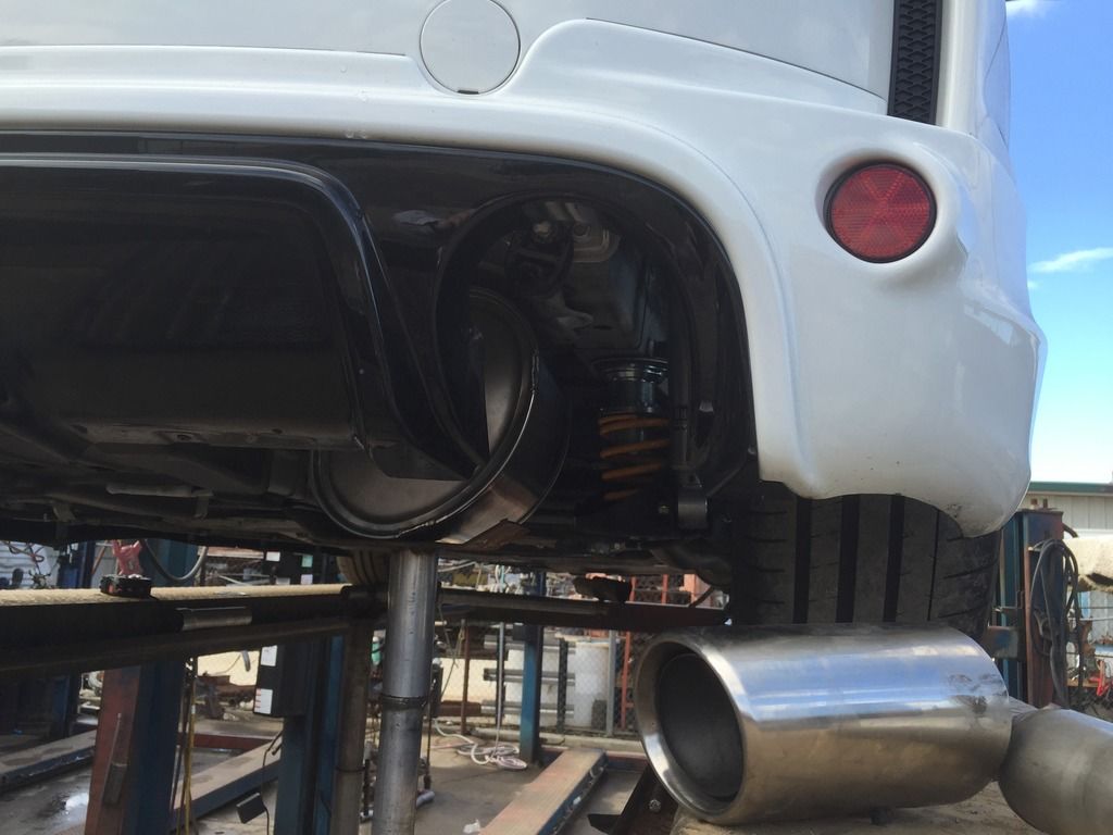

Hi,
Mine don't line up too, I am not sure if this below can be applied
for your situation, but here is what I did yesterday:

Hello,
My current piping is 2 1/4in in diameter,
and it is actually a bit smaller than the piping in the Civic Si resonator that I used so it is kinda slip inside it,
I don't think the welding going to cramps the flow of exhaust?
Because
It start from the second cat back opening at 1.75in pipe anyway,
so there is already a bottle neck with just 1.75in pipe outlet of the second cat...
so that is why I think
2 1/4in in diameter should be big enough to over come (if there is any) problem with some welding protrude inside the tube,
If you enlarge the picture, they way they weld most of the pipe
is
they enlarge one pipe and slip it on to the non enlarge pipe and then they weld it,
so as far as I see,
there is no welding that protrude into the piping that cramps the flow.
Here is the picture of one of the slip on joints before welded:
and another slip on joint here (which later welded):
(please note how they enlarge enlarge the joint above)?
