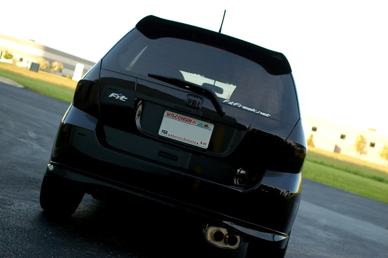

I did mine with vht spray tint. Just 3 coats on the outside of them then 2 coats of clear. No prep work besides a good cleaning and rub down with alcohol.
I wouldn't go that dark on a ssm tho. I would do only 1 coat of vht and clear maybe.
