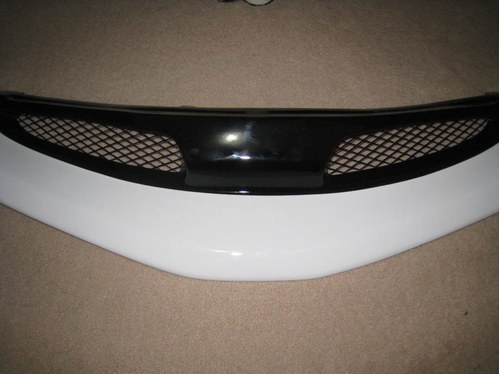

well, I have a mugen grille (lookalike) going to put in on my GE8, however, it seems i need to take off the whole front bumper in order to replace the grille, any one knows how to do it?! or shall i let someone in mod shop do it?!
here is the grille:

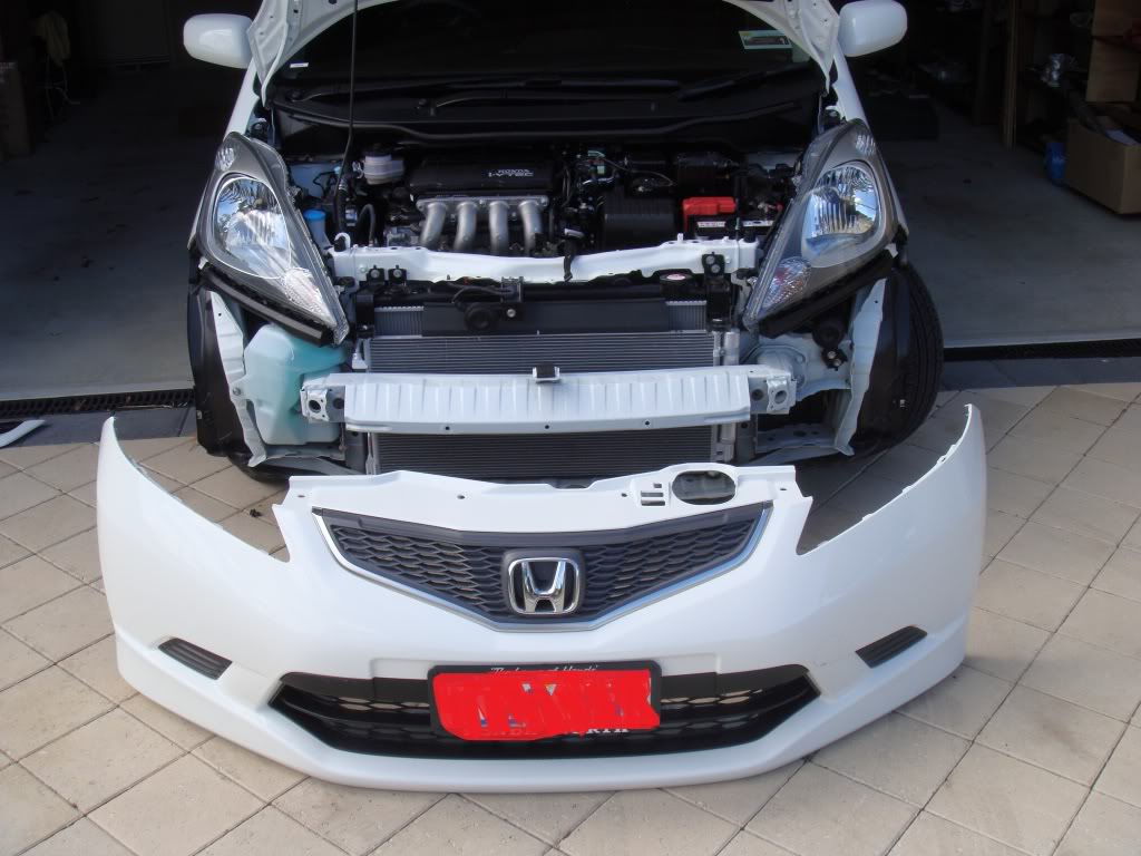

hey i managed to replace the front grille myself, and I actually follow a manuel of replacing fog lamp on GE8 (involve the steps of removing the front bumper), i will post the doco later as im in office atm...
see the front grille actually sit inside the front bumper that need the whole bumper remove before replacing the grilleName:  JY_3.jpg

Hi, i have no idea how to upload the pdf file, anyway i have the original web where i D/L the pdf file from
http://estore.honda.com/ext_html/pdf/fit/fog_lights.pdf
if the steps in pdf doesnt help, or you get stuck in removin the bumper, let me know and i will try answer you from my memory

you will be alright jtest, this doco is published by HONDA...you gotta trust them, However you also need lots of guts, its not easy, that pdf should give you enough information to go, just read carefully and do it very very carefully, when I finished replacing the grille i talked to myself, "oh mann, that was tough, i will never ever remove it again..." so...good luck
