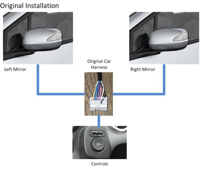

here you go courtesy Kotarou of fitfans.br who was kind enough to make it for me two years ago.

playing with the mirrors today and this is what I found
L.H. mirror has 7 wires
folding - black, white
movement - brown, blue and yellow
signal - pink (-), purple (+)
R.H. mirror has 9 wires
folding - same
movement - same
signal - same
extra 2 wires are orange and green and I don't know what they are for
not sure what gen mirrors are they as they are JDM ones RHD
so if anyone knew what the extra 2 wires are for please let me know thx.
Old Jul 10, 2014 | 11:45 PM
xxryu139xx's Avatar
Joined: Aug 2012
Posts: 3,354
From: Union, NJ
probably for heated component
