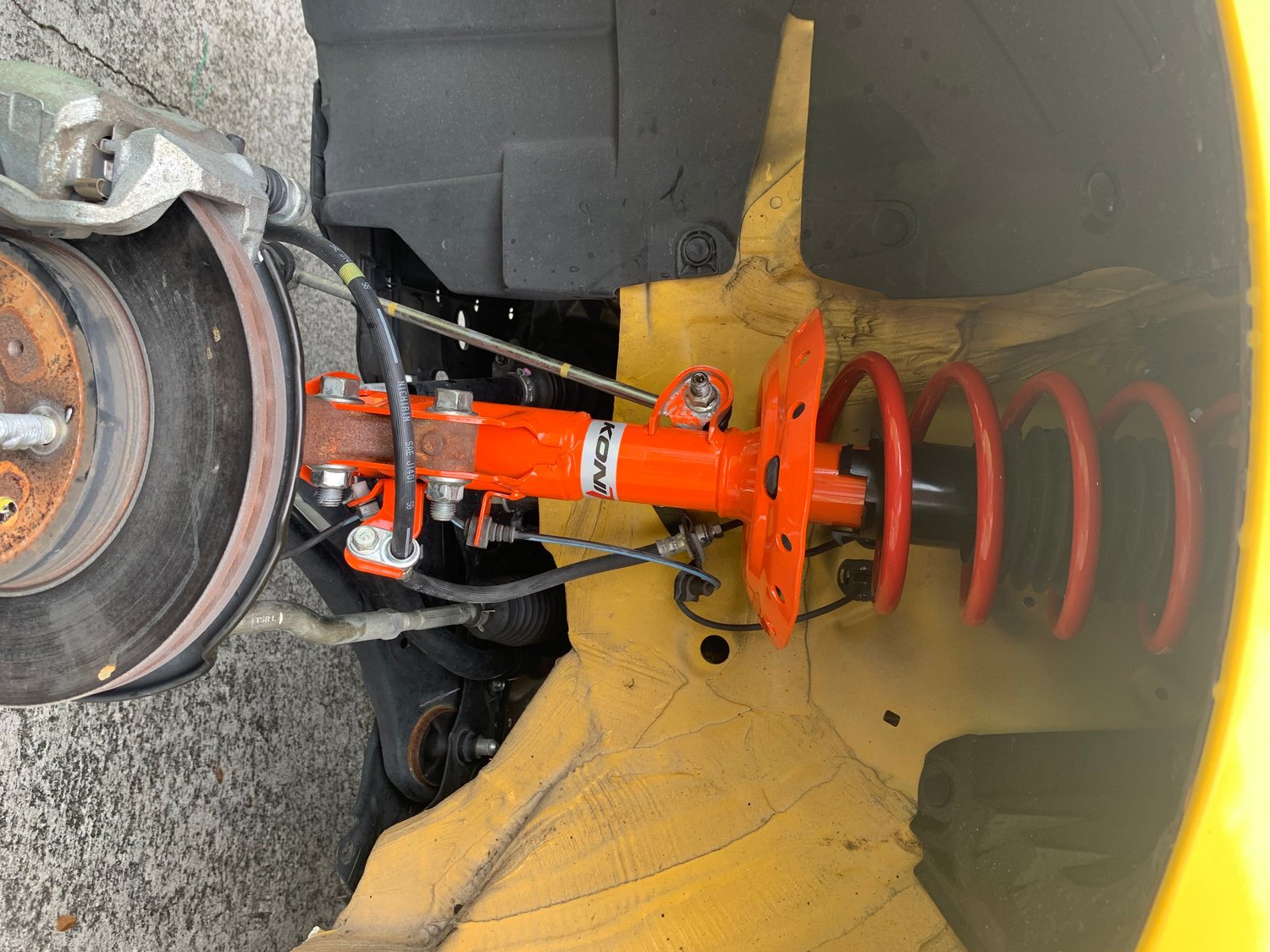

So Big update for the Fit!
As I have been dailying the Fit for almost a year I have officially decided I cant stand the stock wheels. I wanted to like them but I just cant so I have decided to upgrade.
As it is my daily I wanted something comfy yet sporty so shock and spring is the move.
I went with Koni Streets (Orange) and Tanabe Springs. Lowers me 1.4 inches and keeps the car comfy yet stiff enough to have 0 body roll in corners.
The rears were a breeze took maximum 30 mins while the fronts took 3-4 hours. One of the most difficult suspension installs I have ever done but I am happy it is done because I am very pleased with the results.
Now you maybe asking yourself where or what are the wheels? That answer will be here hopefully presented to you all on Wednesday I am still waiting on Tire Rack to deliver my tires.There tracking info lied to me when it said they got there on Friday.

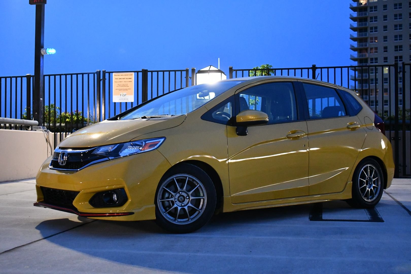

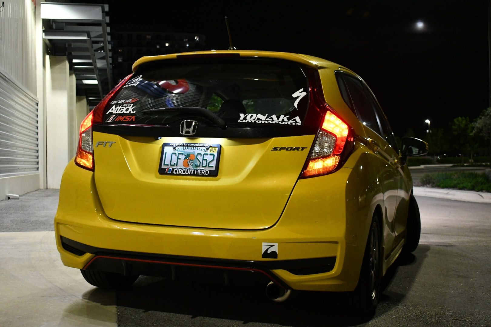

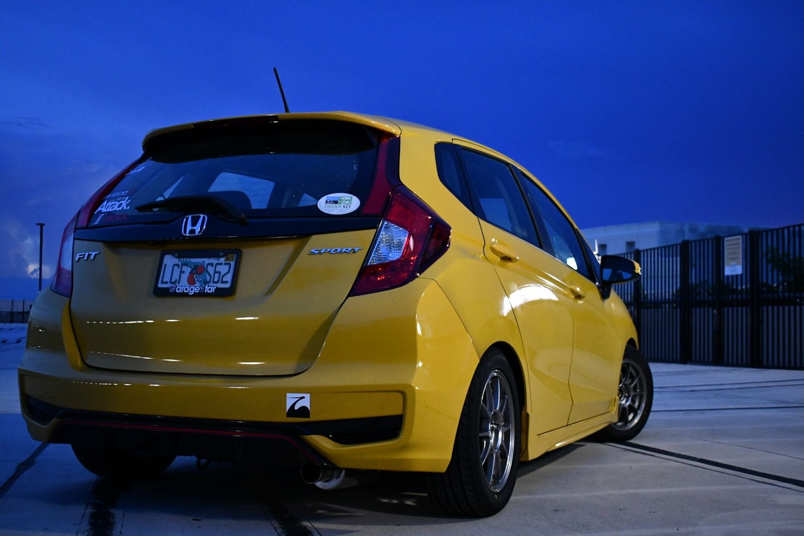

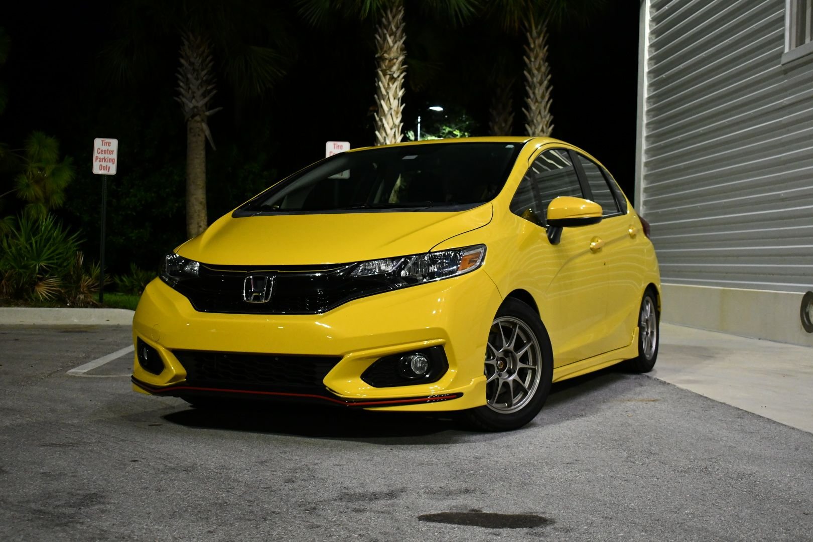

MaRcOp01o's Avatar
Joined: Sep 2019
Posts: 59
From: Miami

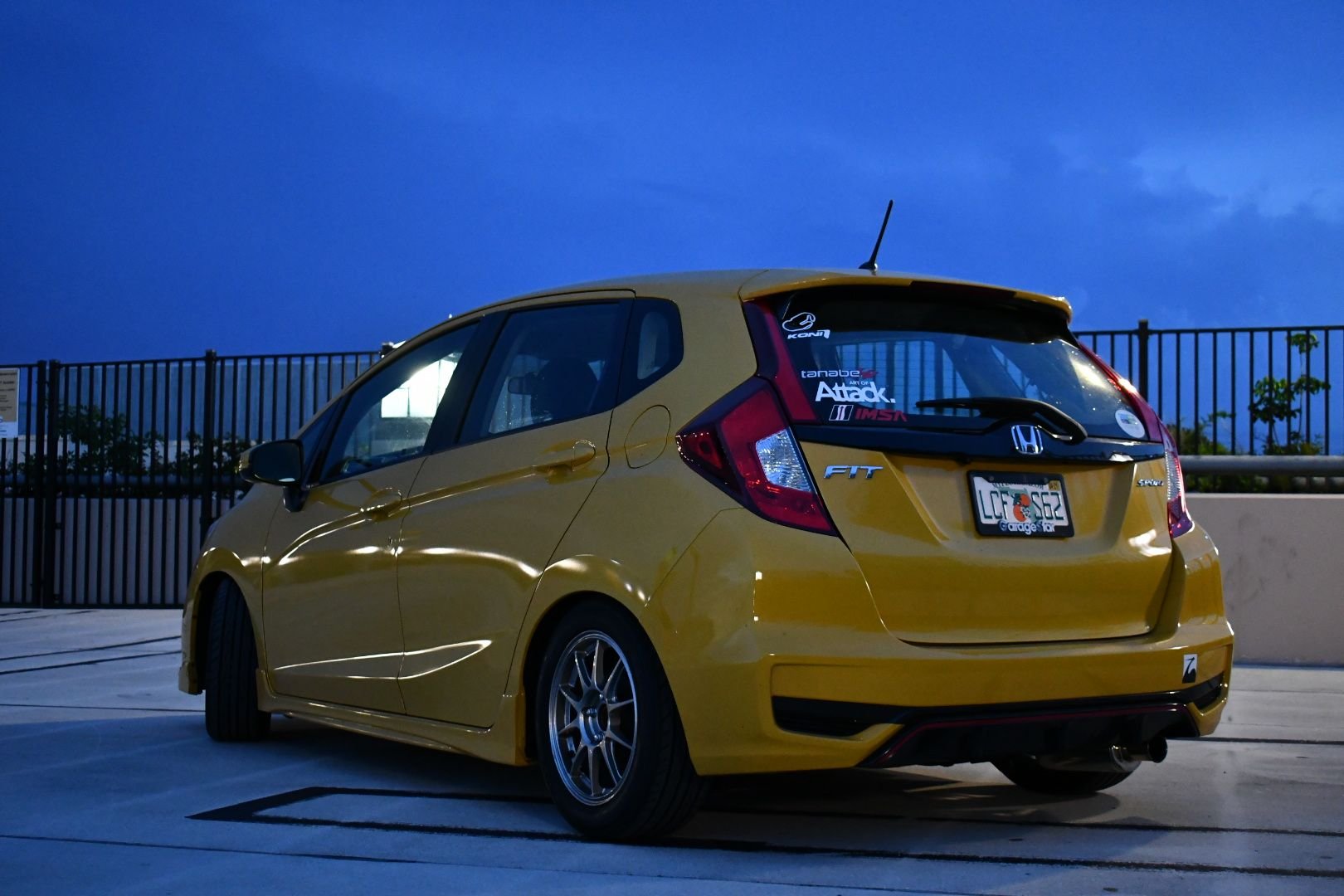

As promised they are here and they look so dam good!
I went with WedsSport TC105N in 15x6.5 +43. They are incredibly light at 10.2 LBS and are half the weight of a stock wheel which is 20LBS.
Tires I went with are Yokohama Advan Flevas in a 195/55/15.
With the wheels and suspension the Fit is on rails. I love how it looks now and I am satisfied with it aesthetically. I have an Autox next month and I feel it will do fantastic!

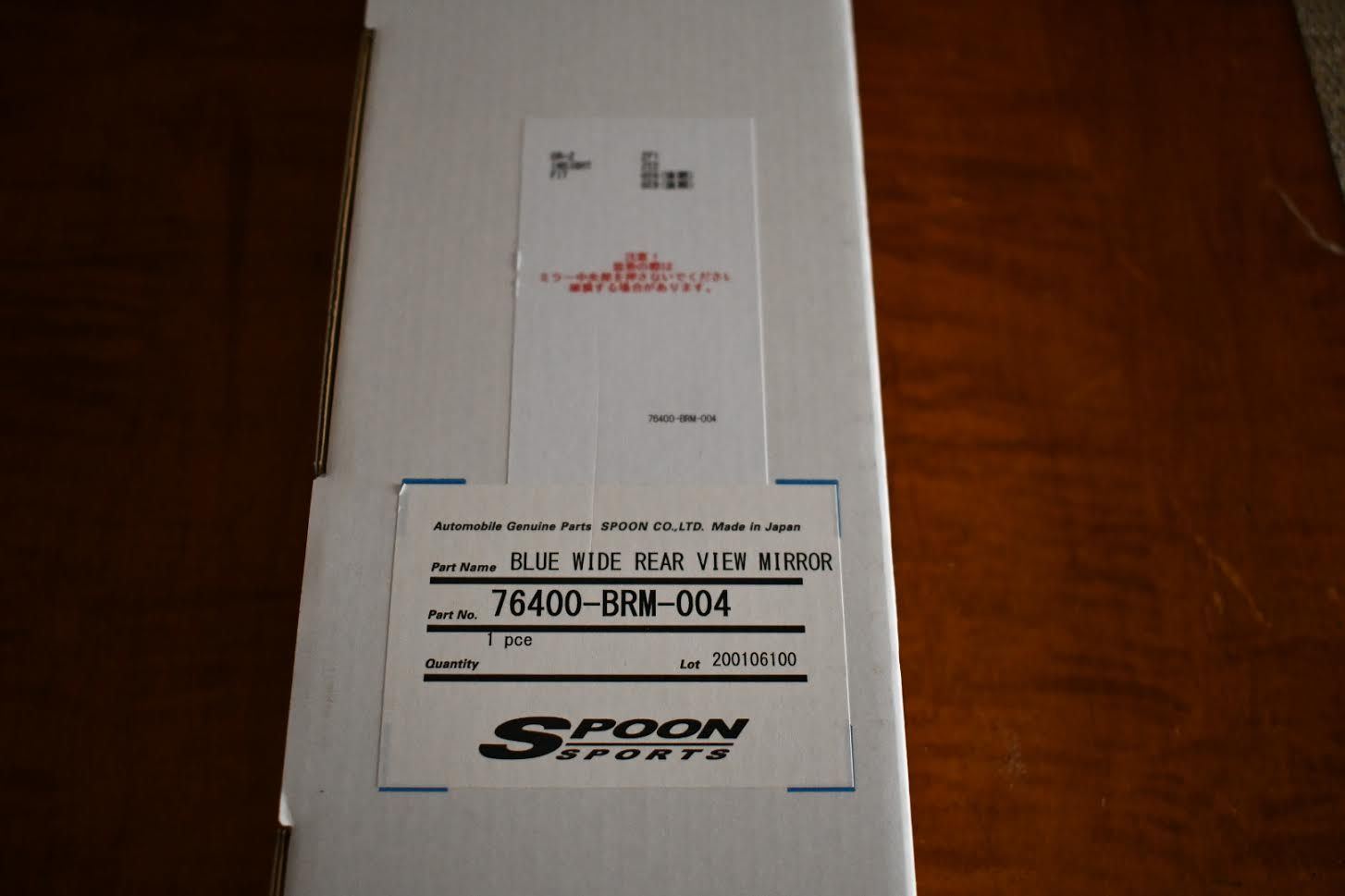

The advantage of the Fits spacious interior is the lack of blind spots but the stock mirror only allows me to "Check my 6" with the new mirror I can check my 3 through 9.
Behold the Spoon rear view wide angled mirror with blue tint.
Really helps with night time driving and it maintains its ability to see far but not have the cars look they're farther away than they actually are. For the price its a no brainer upgrade and makes the interior ever so subtly different which I like.

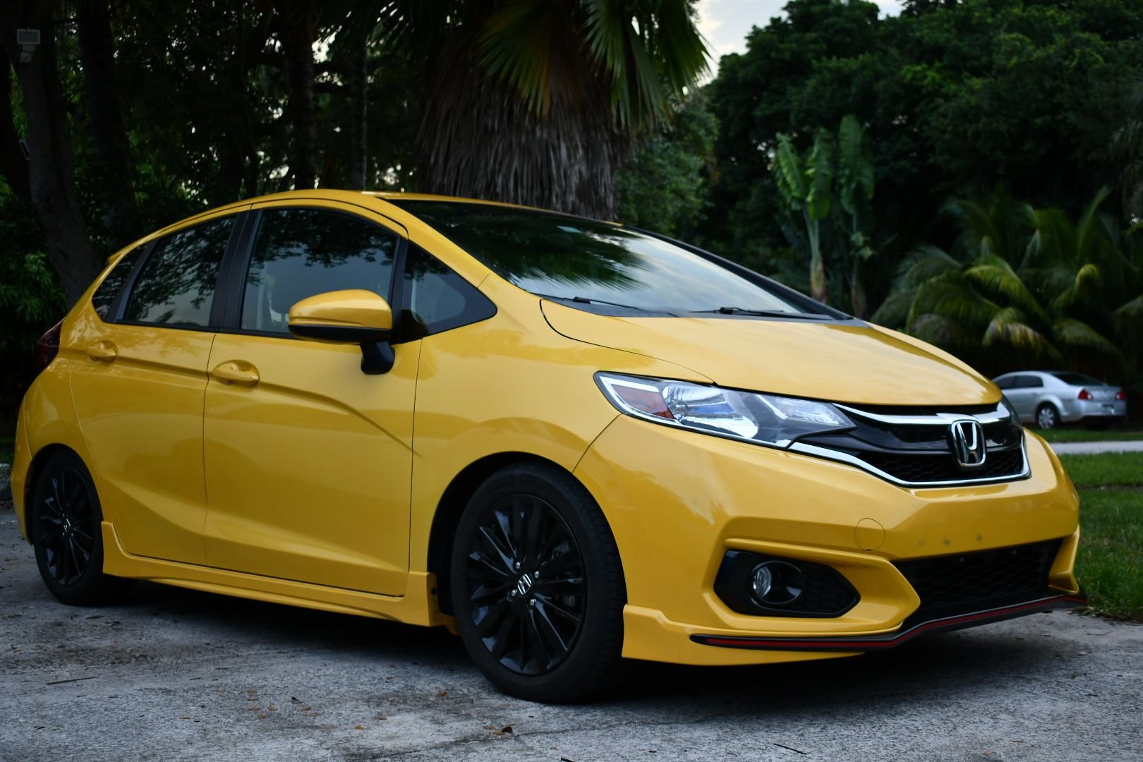

Update Time!

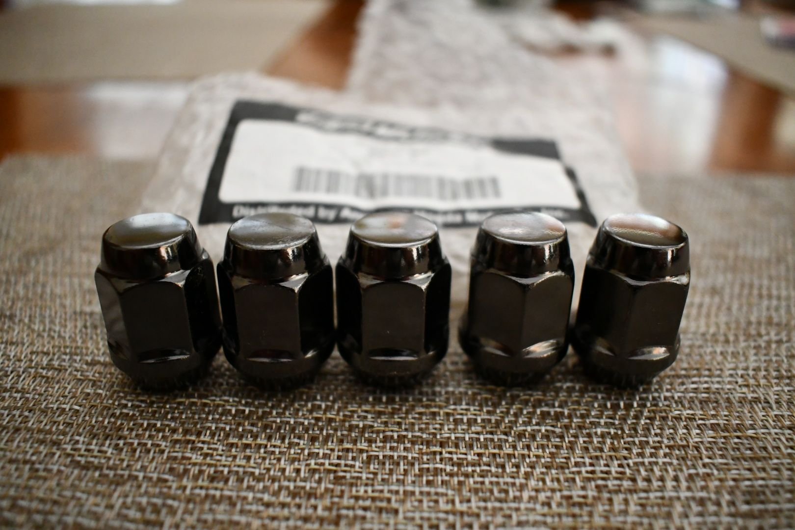

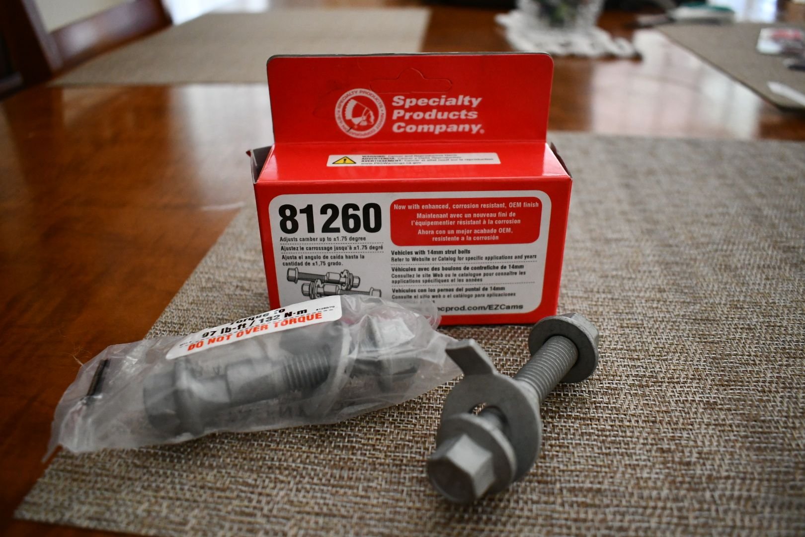

So to get the most out of the Fits OEM Suspension design I decided to go with SPC 81260 Camber Bolts. I read these work well for the Fit and they do! I am running 1.2 Degrees in the front, I know thats not much but it is my daily and I would prefer some tire life.
While the wheels were off I wanted to change the lugs to a little darker tint. The Mugen lugs did just that, although more expensive than most they look perfect. Plus cant go wrong with Mugen.
After all was done it was picture time.
