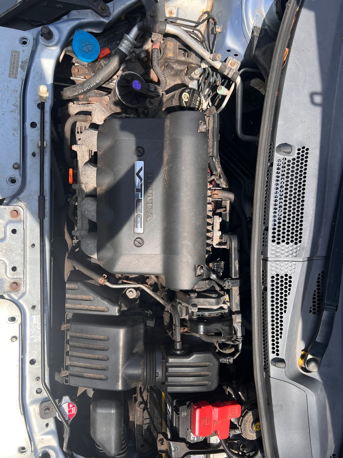

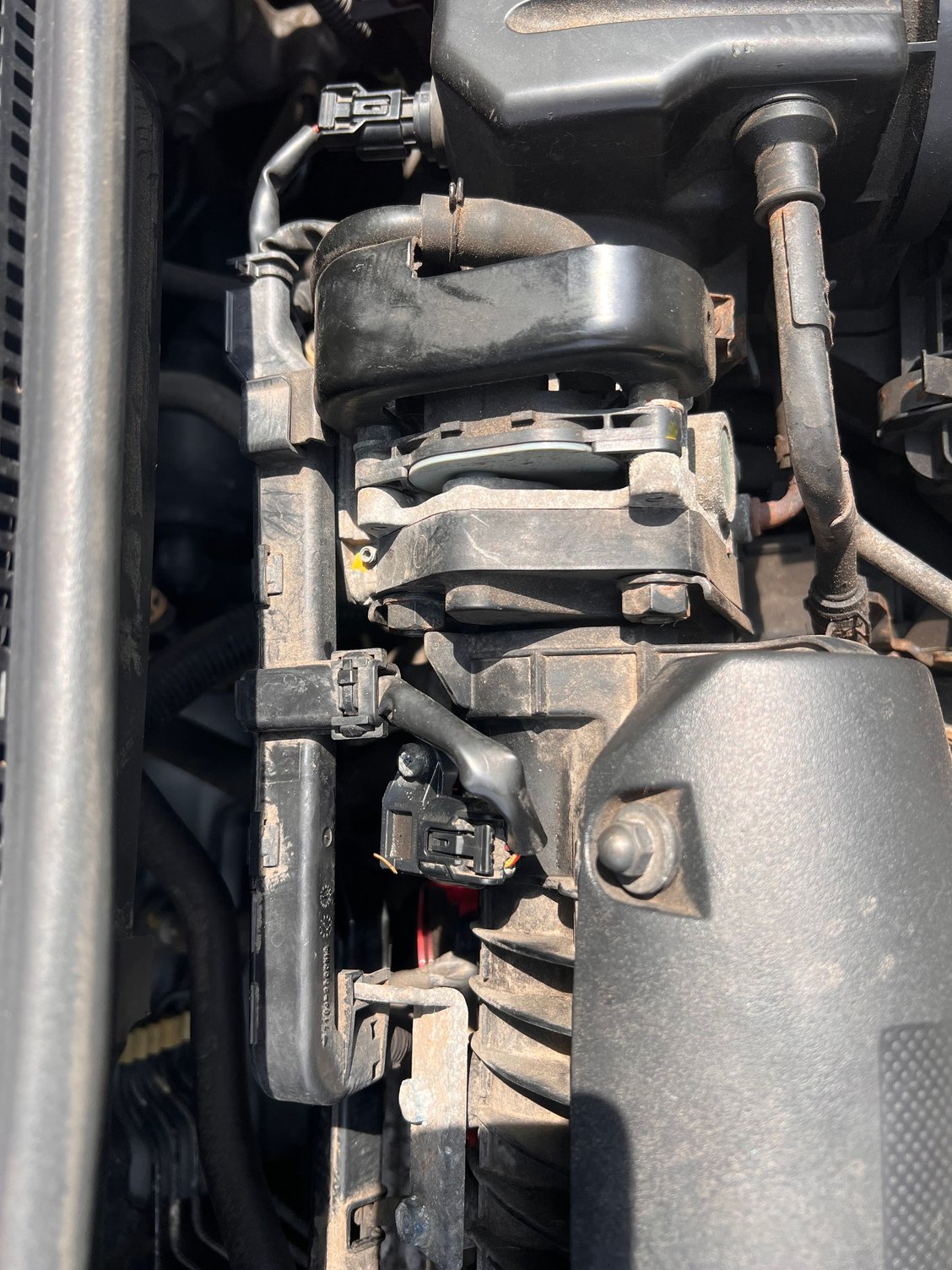

this is the screw that I mentioned

That 3-wire bit is indeed the MAP sensor. The large plastic part it's attached to is the intake manifold. Specifically, the log-shaped portion that runs across the engine is the intake manifold's "plenum", while the tubes feeding each cylinder are called "runners". In the top half of your last pic, the aluminum part between the intake manifold and air intake/filter/muffler box is the throttle body. The throttle body also has a fuel vapor emissions valve attached to it (the black plastic bit on top), and the large drive-by-wire servo motor that moves the throttle plate to control air flow into (and power output from) the engine. Older engine designs have a cable-operated throttle, where the accelerator pedal (gas pedal) mechanically operates the throttle.
