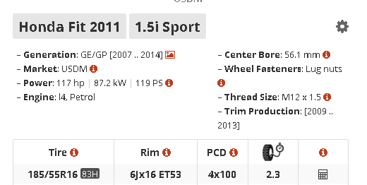

i'll assume your existing wheel setup is:
16x6 et 53
per https://www.wheel-size.com/size/honda/fit/2011/

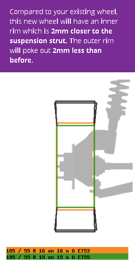

pulled up some numbers on this website:
https://www.willtheyfit.com/index.ph...h=6&offset2=55
