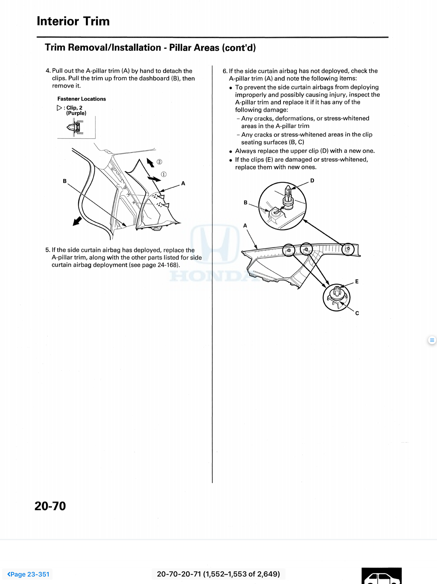

You need belts from a 2008-2013 Second generation . Here you go , check E-bay there are a couple of different salvage yard selling the rear belts . The interior panels you just need a panel tool to pry & release the clips see the instructions attached .
No, you need belts out of a 2008-2013 there are several available on eBay just search . They run about $ 75 a piece, As far of accessing, All the panels just snap in you need a panel release tool to pry and pull pull you need a panel release tool to pry and pull.
