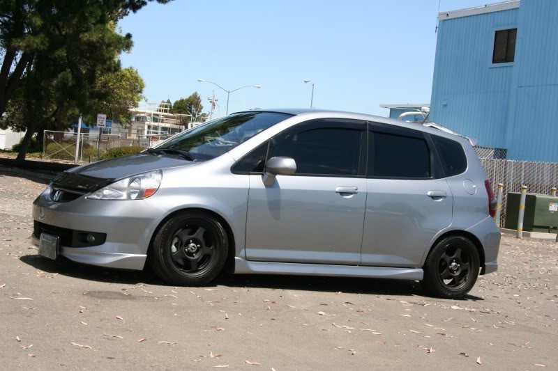

Old Jul 7, 2008 | 09:04 PM
solbrothers's Avatar
Posts: 7,343
From: Vallejo, Ca
dark tint in the front. darker tint in the rear :P
