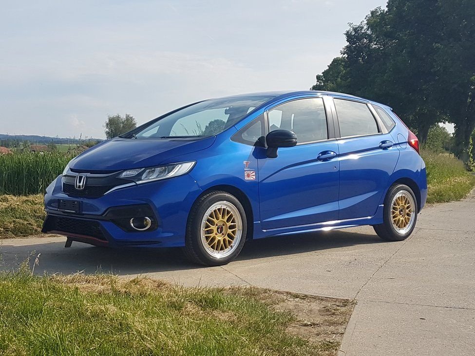

A Dutch EUDM GK with OEM LED. Perhaps this is indeed possible.

Dutch, German, French, just about any "mainland" EUDM should work. The ones that won't work are UK and few RHD drive countries (according to wiki, there are four in Europe, and they're island type, like the UK).

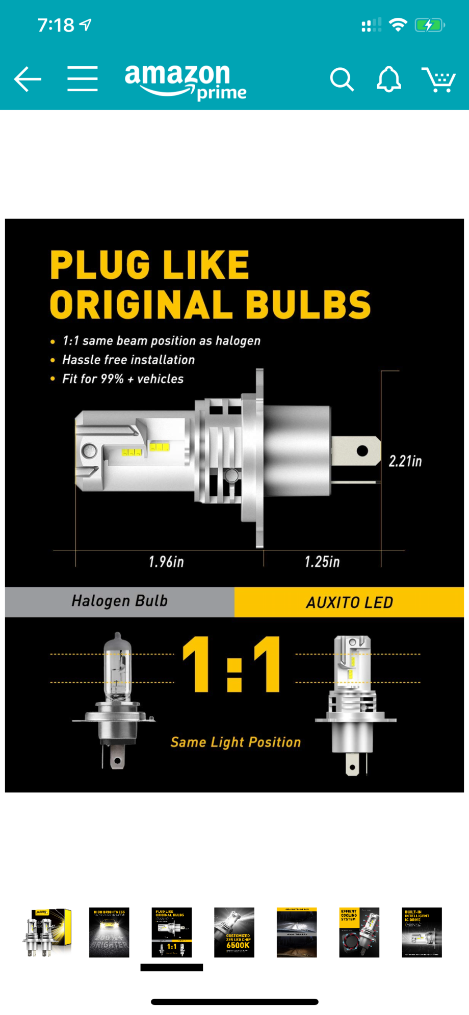

These bulbs are only 49.99 on Amazon Prime (including shipping). They allege to replicate the position of the H4 bulb in reflectors, and they say they are designed specifically for reflectors.
I worry that the fan and heat sink are inside the reflector housing, because of course the air is a lot hotter in there. But they are cheap enough that if they blow it will be easy to replace them. The manufacturer projects 30,000 hours, which is more than I'd probably ever need for this car.

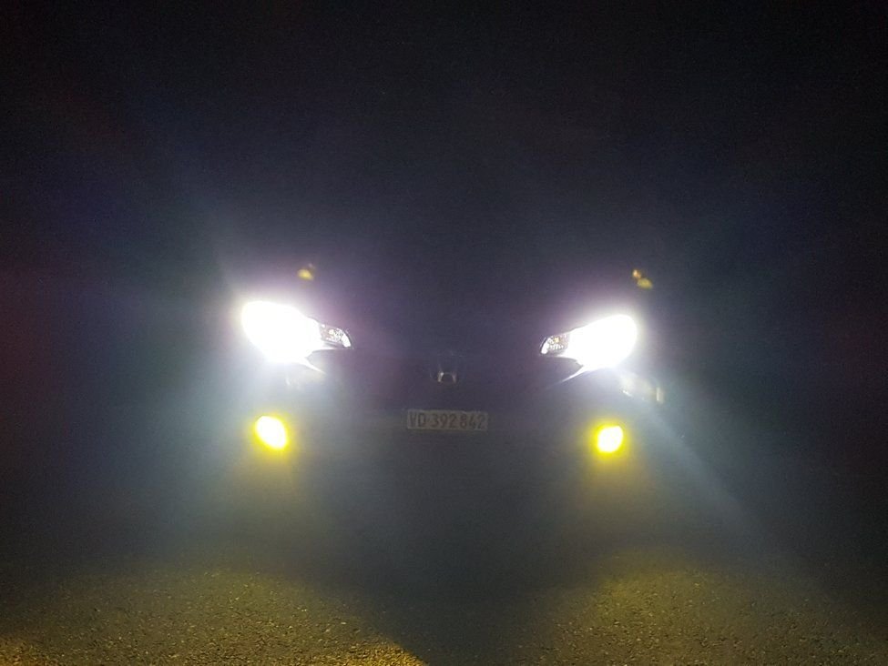

They are not as bright as a lot of other bulbs. Testers say 200X H4, and you'll be aware that there are a lot of bulbs out there that promise quite a bit more.
The light pattern is not perfect, but it's a hell of a lot better than the H4's. No visible flaring or dark spots, but not perfect. Nobody's flashing high beams at me.
Everything works, including constant, no flicker DRL. But the DRL are really quite bright despite the reduced power, and you might want to think about pulling the DRL fuse if it is allowed to do that in your state.
