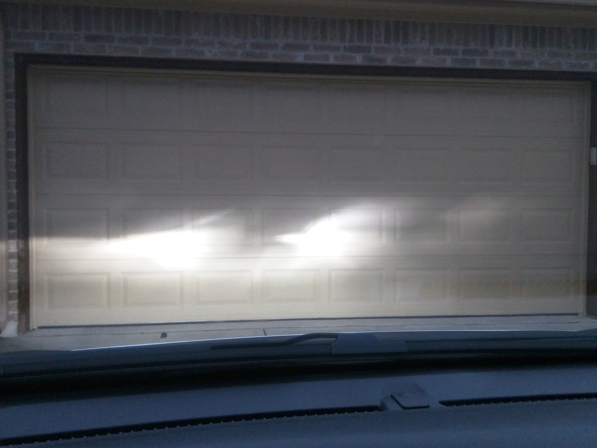

Update:
Installed LED headlamp. Observations:
  • When installed w/o canbus decoder, there is DRL flicker but only when viewed from a camera lense; not visible to the naked eye. The DRL brightness is identical, far as I can tell (meaning quite dim), just like the factory halogens.
  • When installed w/ canbus decoder, the DRL flicker stops but it looks like the headlamps are on high beam all the time (headlight switched turned to off, meaning DRL mode runs on default). See pic below:
  • When headlamp is actually turned on, it looks 'normal'. See pic below:
  • Happy to see that neither mode blinds oncoming drivers, which was my main concern installing LEDs on reflectors. I usually set the headlight on 'Auto' so that the so-called high beam only comes on during the day.
  • I might decide to take out the canbus decoder and simply have DRL flicker (again invisible to naked eye). From what I read, flickering LEDs do no harm.
