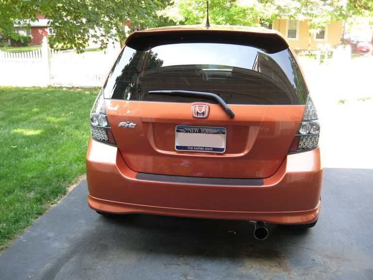

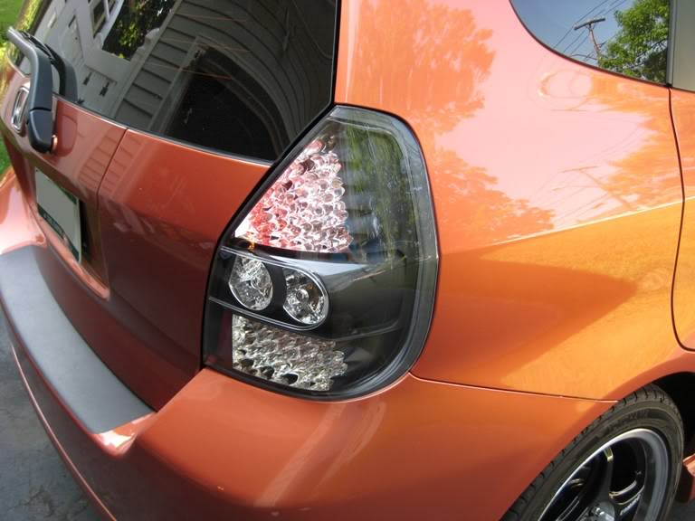

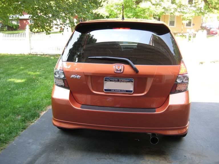

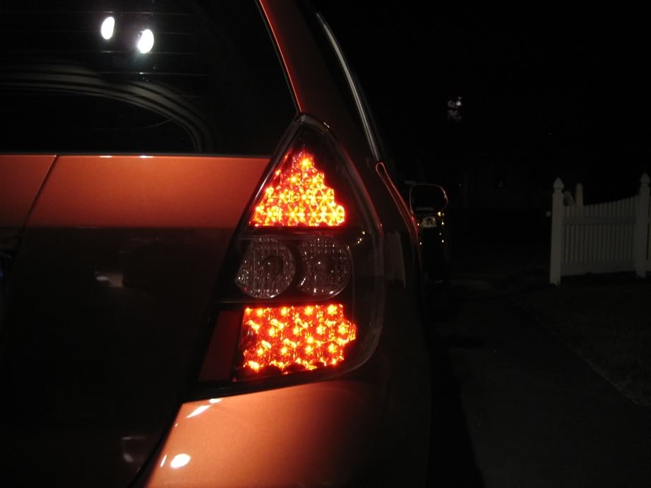

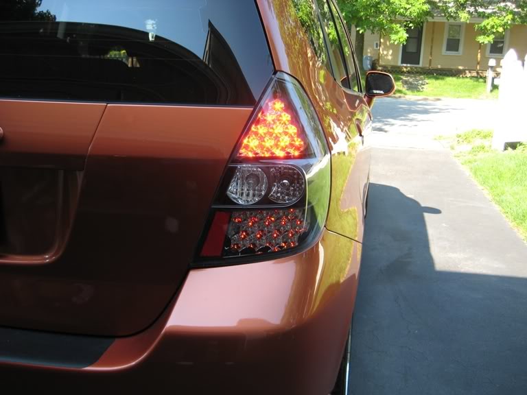

OK so just slapped on a different set of LED tails, as well as an LED bulb in the 3rd brake light. I noticed this morning, when I step on the brakes, the headlight icon on the dash comes on, as well as my front marker lights. Anyone ever experience this? I think I ran into something weird like this years ago in my Jeep, so I just removed all the LEDs and all was fine, and I never looked into it further. I removed the LED in the third brake light, same deal. Later tonite I am going to try and remove the LEDs from the front marker lights and see if that fixes it. Maybe just too many LEDs that are throwing the system off now? I wonder if thats a feature to let you know that brake lights arent working, sort of the way the hyper flashing lets you know of turn signals that are out. Anyway here are some pics, I kinda like the looks of these, and the LEDs are brighter than the other LED tails that are in my sig. The 3rd brake light pic shown is with an LED bulb in there. Looks basically stock, just get the instant on/off with it.
