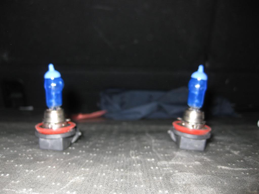

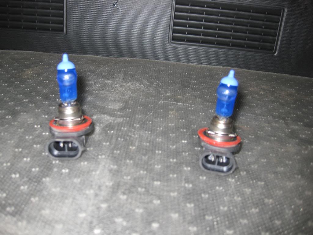

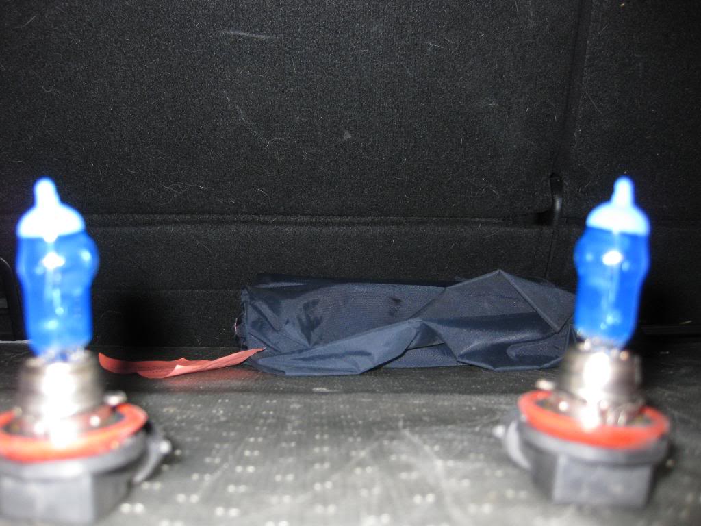

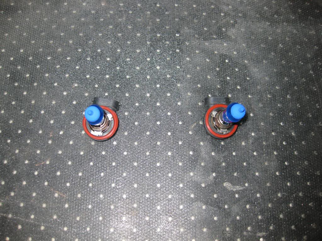

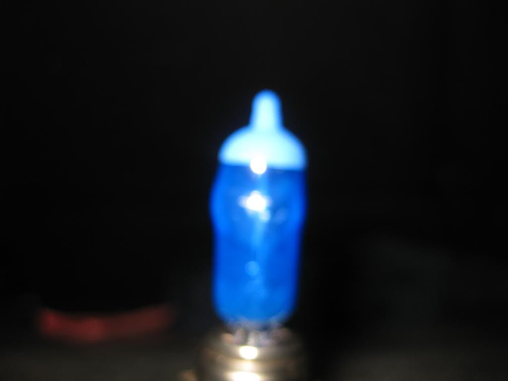

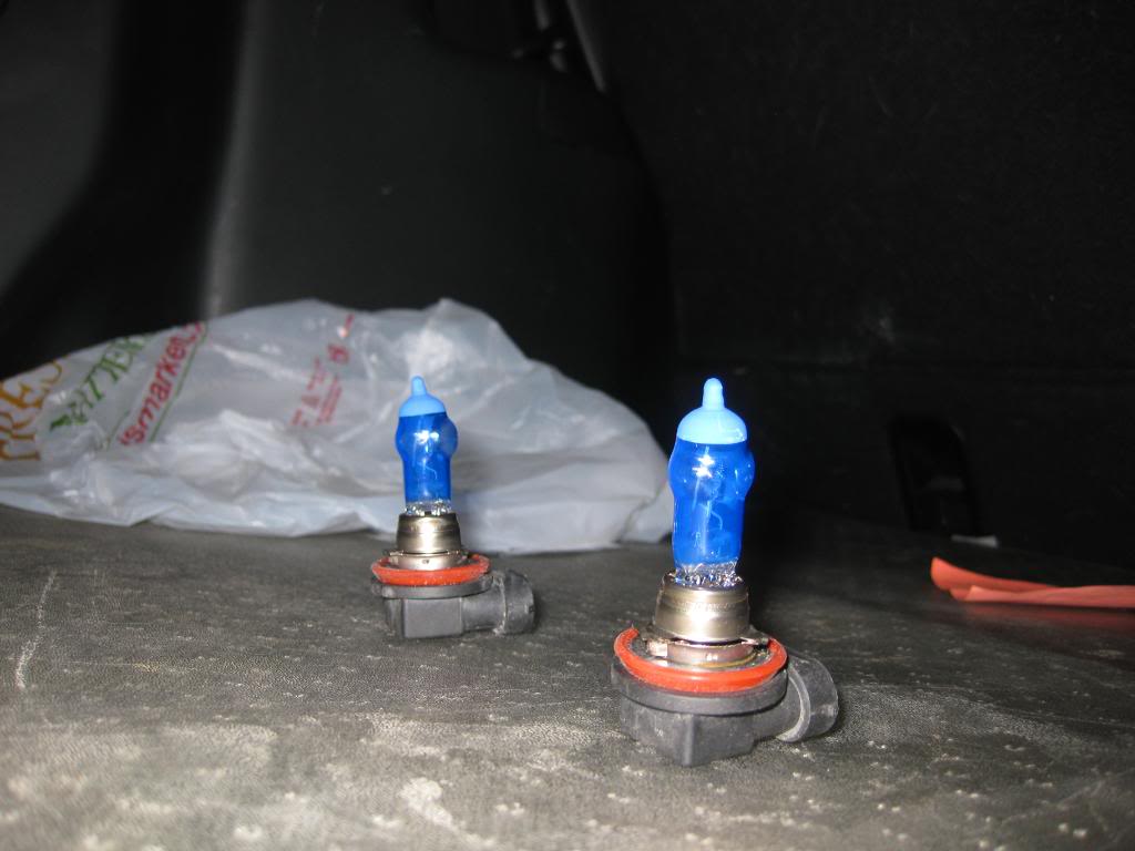

Its been a few months since i put in the bulbs, im not sure if they got any dimmer over time. woudnt be able to notice it. but one bulbed went off so i had to replace it right. i take it out, and i notice like the tip is bulbged, like the sides of it. i was worried about this... then it hit me, i hjave the independant fog light mod, and its set up to stay on with the high beams. its been this set up for about a month? maybe 2? i replaced it with the same exact bulb, replaced both. oh and both bulbs were bulged. heres the pics. can someone tell me whats causing this? so i dont do it again =\

heat from high wattage bulbs my nokyas did that.. put back oems and never happened again..

that happens a lot with high wattage bulbs. I have even seen it on OEM bulbs quite regularly. usually they start to get dim and one will burn out, then you pull them and they are all funky shaped.

Buy standard wattage bulbs with a xenon or krypton mixture and you shouldn't have any issues. OEM bulbs will still do this when they get old. I run with my lights on all the time just so people see the lil silver jelly bean coming, and all my other rides have nice HID setups, so its nice to show em off, even in the day :P

yep same thing happened to both my luminics and nokyas in my fogs, i replaced them with some 3000k hids with yellow film and never happened again
