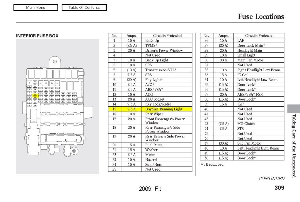

how do u disable drl?
Pull the fuse. The fuse for DRL controls only DRL and nothing else.

Posts: 65
From: Los Angeles
yeah but which fuse was what i was wondering. i searched and found. thanks though.

I dont remember since I still have it in, but I think #15?
Nvm, you said you found it. Good job!

What ones #15?

Originally Posted by FITMugen
Thanks so much this was my biggest pet peeve with the fit lol yes the drls lol
