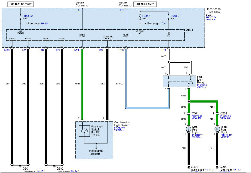

Do I need to bend a 5-pin relay's pin or what?
I want to keep fogs on when I go to high-beams, that's all. If someone knows where the fog relay is, I can do a pin out and bend the pin that shuts the relay out of the way.

Best I could find for ya..
Old Dec 18, 2012 | 08:27 AM
BlueBoogers's Avatar
Posts: 1,729
From: ATL
WTF how is it not a 5-pin relay. I must not have enough of a grasp on electronics.

Most of the pics/DIY is down, but there was a DIY on here a while ago where all you did was use 1 wire to tap into 2 different locations, and it worked, with or without headlights and/or highbeams on/off. Fully independent. I did it, but it's been so long ago I'd have to check the locations again.
This is the original thread --> https://www.fitfreak.net/forums/2nd-...operation.html
you could try this one too --> https://www.fitfreak.net/forums/2nd-...foglights.html Not sure what ever happened with that route.
