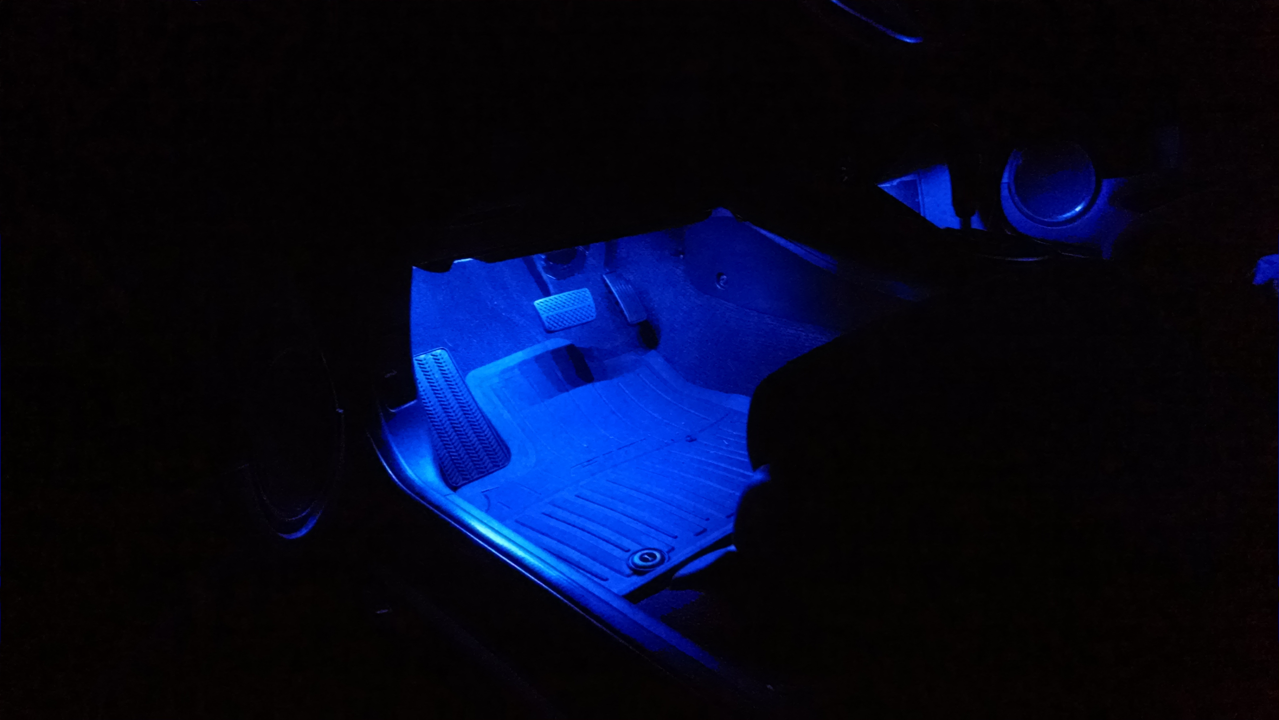

Hi guys, wanted to share what I did with my sunday off. I'll post some more pics of the wiring when I get home.
I picked up a set of these multi-colored led's from pep boys (had a giftcard) and wired them into the dome light harness so that they would come on when the doors open, unlock the car, ect... Then I decided that I wanted manual control as well so I picked up a SPDT switch from radio shack and wired it up so that one ground went right to the body and the other to the oem dome light harness. This way the switch works identical to the dome light switch. OFF/Doors/ON)
And here's a video, gives you a better idea of what it looks like and how it functions.
