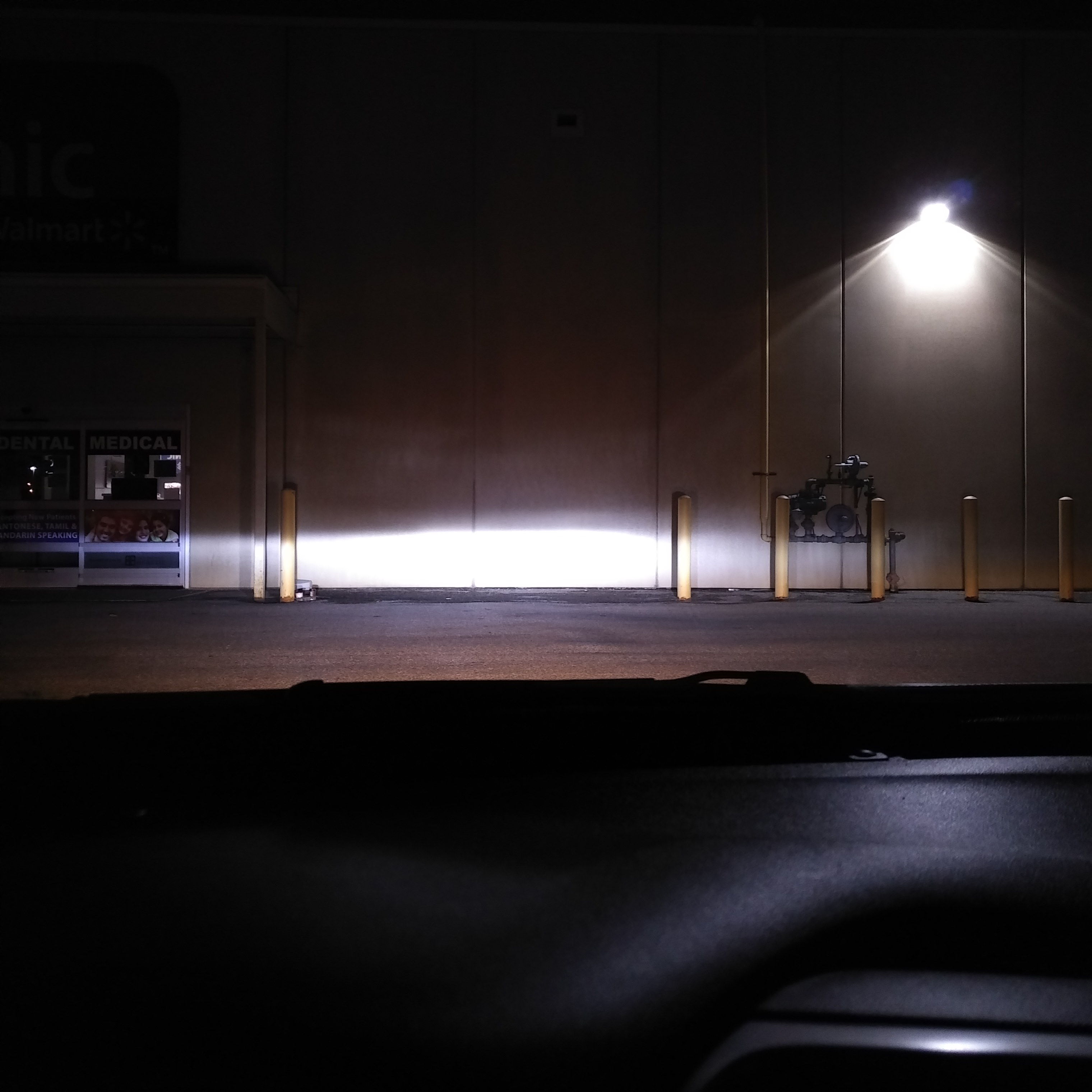

Here are the wall shots. As you can see the glare from these LED Putco bulbs in minimal andfocused well for driving and avoids blinding oncoming drivers.I’ve yet to be high beamed for running thesebulbs though they are significantly brighter.
Wall Shot Low Beam only:
Wall Shot Low Beam and Fogs:
Wall Shot High Beam Only:
Wall Shot third person Low Beam Only:
Wall Shot third person Low Beam and Fogs:
Wall Shot third person High Beam Only:

A head on photo of light output is useless. Do a wall shot. I did.

I've been flamed for not having wall shots and some of you have made assumptions that the glare would be awful. I'd ask a mod to erase those comments because they are unfounded.
I added wall shots and you can see that the cut offs are remarkably clean and glare is minimal. Putco LEDs in our stock housings are a great combo; bright as hell, white as snow, and no glare.
They are pricey, but I consider it them some of the best LED bulbs I've ever used or seen.

I'm a mod and I'm not deleting my comment. If you look at your wall shot, the light above your "cutoff" is glare. It should be dark.
This is a cut off from a projector with HID.
I'm sorry if you think we are flaming you. We are not.

You invited criticism in your first post. If you were in reality just seeking or expecting positive affirmation, you should probably avoid car forums.
The cutoff and beam pattern in your pics looks rather lousy. It might be seen better if you put more distance between your car and the wall. But, as xxryu139xx said, there's obvious glare.

You're comparing a focused projector with a reflected halogen housing Ryu. Though the Fit has a relatively flat cutoff for a reflector halogen, there will always be bleed without projectors (whether halogen or HID).
I just installed LED bulbs in the stock headlights and it's at least double improved. Drove home at rush hour, nobody high beamed me. The bulk of the light remains right where it should be and didn't creep up past the average license plate level.

In our halogen setup, there is a relative cutoff, but there is also some stray like above the cutoff to allow for the driver to see reflectorized signs. Too much (or unfocused) stray light and we have glare.
My Phillips LED bulbs do have shields to help focus the beam. There is also stray light above the "cutoff blob" to help light up signs (very, very nicely) but without lighting up the interior of the car ahead of me. This is a 65ft shot.
