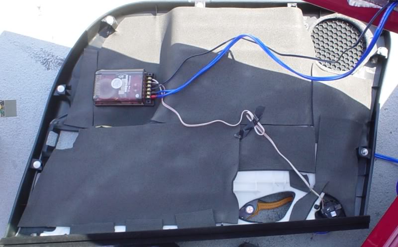

I mounted mine on the door card in the front doors. I cut off the hollow plastic box with a dremel and mounted the x-overs with mounting tape.

pic of what i did
