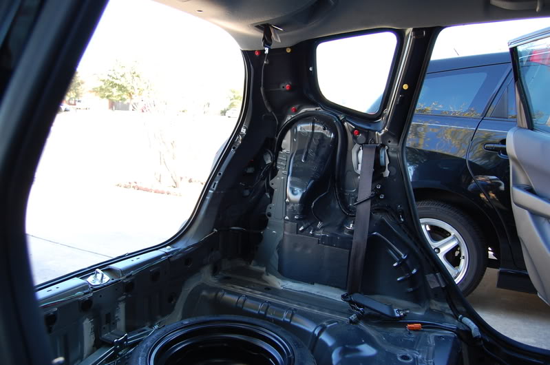

sorry ive been putting off weighing the car guys. but ive got the next two days off of work so hopefully when i wake up today i can rip out the headliner and all the other little bits and pieces from the interior that i dont want and can get it weighed. i will definitely post up the weight as soon as i do.

F'it_ImFromTx.........any chance you might want to sell the rear panels
its a definite possibility. let me put a little thought into before i do something i might regret in the future. were there any specific panels you had in mind or all of them?
the 2 bottom back ones Left Side and Right Side.
they cover the strut tower and hide the rear seat belts.
