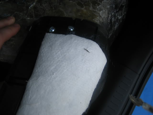

I plan on anchoring mine to the tailight access panel.
I'm going to use 1.5 inch bolts with lock washers and wing nuts.
the bolts will be inserted from the inside of the access covers and i'm going to silicone the bolt threads just before I tighten the wing nut.
this way if I ever decide to remove the subs I can just by new panel covers.
If anyone out there has experience that contradicts my intentions please let both of us know in the next two days, Before I myself attempt this.

The bolts in the tail light access panel covers work great, bolt them to your enclosure then pop it in place, use a little bit of maneuvering and it will sit flush again.

I placed the fiberglass box into position where it resides in the corners, and drilled a hole through the fiberglass AND through the removable panel.
Took out both and turned the bolt through the inside of the plastic piece then when I tried to put the panel on the fiberglass the bolts would not go through withought reaming the hole a little bit first.
Once I go the plastic onto the fiberglass box with the bolt through both of them, I tightened with a lock washer and a wing nut.
I was not too worried about the air seal because i just squished the rubberized undercoating that i sprayed into the interior of the box with the lock washer.
Good luck, sorry i don't want to take it apart again, i had to finish up the install yesterday before it rained while i was out in my driveway so no pics of the process.

picture of this box please
Quit your bitching!
here you go.
