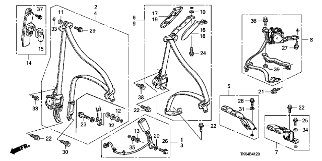

My wife has had hip replacements and the inner seat belt on passenger side rubs on the incision area.
I want to throw a few washers on the bolt to extend the seat belt piece a bit more to the center.
I can see the end of the bolt but no idea how to get at the nut with all the plastic covering it.
Anyone have this apart? If so how? Is it just a matter of prying off the covers? Would it be easier to remove the seat?
Here is pic. Bolt is #26 in bottom middle in bottom pic.

FSM says you need to remove the passenger's seat to get to it. Also warns about discontenting battery and waiting at least 3 minutes to disarm the air bags.
The retractable lower seat belt connection needs to be undone before pulling the seats [simply pop the cover], then you push the seat forward and undo the bolts and unplug the connectors.
Not sure how much you can gain - might need a longer bolt 7/26-20 UNF is how they call it.
Hope that helps - come on back...

Thanks KC. What is FSM ? Field Service Manual? I suspected I may need a longer bolt.
A little confused on popping cover. There is not a heck of a lot of room to work. I am wondering if I just try bending the whole thing towards the middle would work? It is just a flat piece of metal. Being old and decrepit myself this crawling around on hands and knees is no fun.

FSM=Factory Service Manual Not something you'd use in the 'field' in that it's about 5" thick!
The cover is on the retractable seat belt bottom - on the door side of the seat - it's plastic - not metal. Gently pry the bottom of the plastic cover. This will uncover the bolt [#30] that holds the seat belt in place. You'll nee to remove that first.
Then you remove the plastic end covers on both ends of the tracks. Remove the track bolts and the seat will be free. Tip the seat back and proceed with un-hooking the electrics from the seat bottom [one harness clip and three connectors] and it should lift out, allowing you to get to that bolt you're after.
Don't forget to pull both the battery ground first and the positive next. You do not want the air bags to pop, wait 3min+ before proceeding.
As I see it you'll be removing five bolts to get the seat free.
