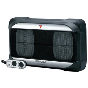

anyway i too think the '12's factory sound system isn't too bad. it's not great, i think it can use a tad more bass for fill. i would either swap with polk db6501's or just add an active self powered mini sub like this kenwood one to the factory unit.
considering the GD, the GE is SO EASY to remove the head unit!!
Amazon.com: KENWOOD KSC-SW10 Dual 5X7 inch 150 Watts Powered Enclosed Subwoofer with Remote: Car Electronics Amazon.com: KENWOOD KSC-SW10 Dual 5X7 inch 150 Watts Powered Enclosed Subwoofer with Remote: Car Electronics

^^^ Looks like a great idea and it would not overpower the other speakers.
op sorry for the semi jack lol
