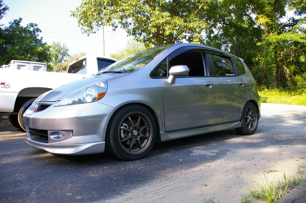

i guess it all depends on how low you wanna go i think progress is a little lower then skunk2 i have skunk2 and i like them.
