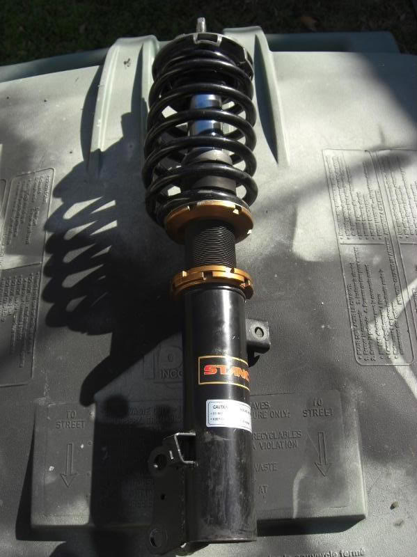

so i bought some used stance coilovers. they showed up and i opened up the box. they were wraped up really well so i just put them in my car and went straight to my friends shop.
i pulled out the rear set. they looked ok. then i unwraped the front set. my friends and i just stared at it all we kept saying that does not look right at all. there was a progressive style spring on the front and the top hats were oem honda. what makes it even worse is that the springs look like they were barely on there. so we decided to switch the front sets with the rear sets, but the springs still look like they are not sitting correctly in the front. they were kinda off to the side. it was getting to late and we are going to postpone the install. i also checked online and the guy i bought it off of said that the spring rates he asked for might not be the ones on there.
yeah i know it is my bad for not taking a closer look at the pictures. i feel stupid.
so before i install:
1.i'm going to another one of my friends shop and we are going to find out if the spring rates are correct.
2.this is were you guys can help me. is anyone on this forum running these coilovers? if so, were your front coilovers top hat OEM honda. also if you own one, how did the springs sit (pics if possible)i'm going to call stance about this too.
oh well back to jury duty. these will have to wait
also i might just change out the progressive style spring and a run linear style spring
UPDATED NEW PICS. JUST KEEP GOING DOWN

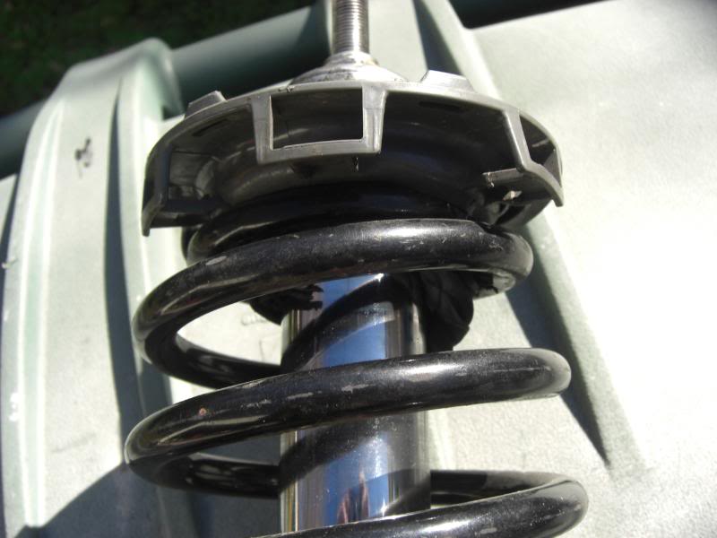

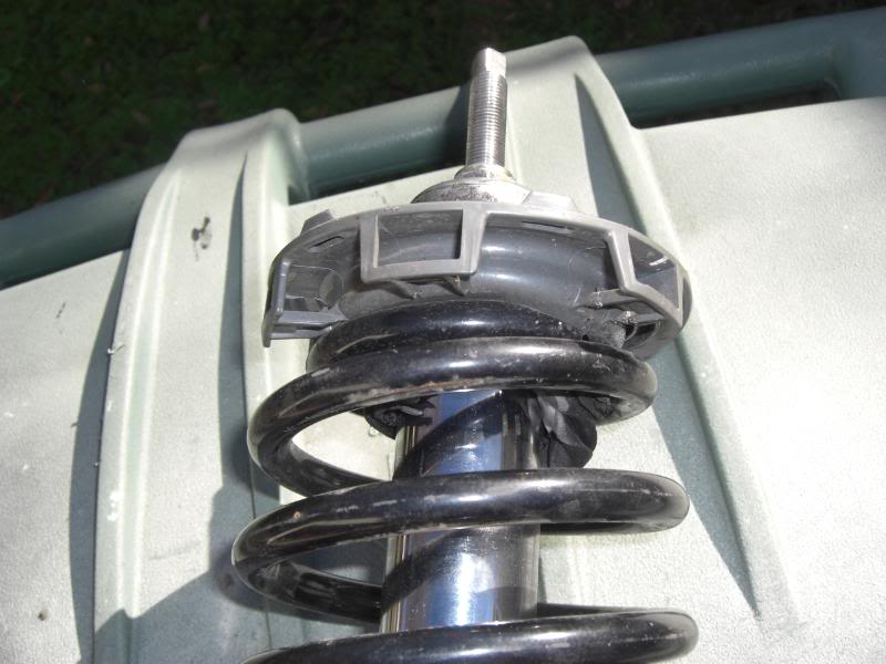

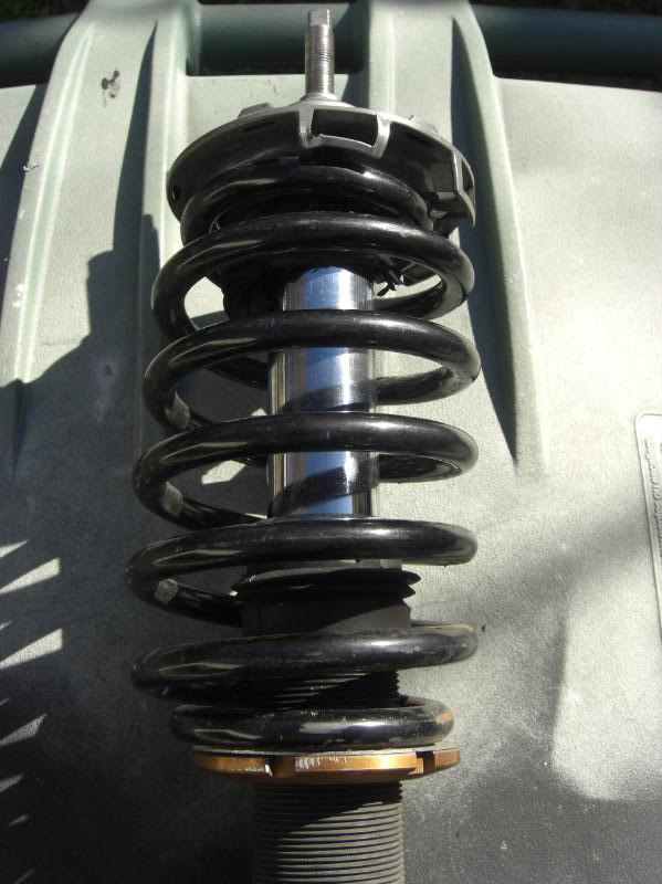

ok. update with pics. i called up stance. they said they do use the oem top hats, but the pics on their home page where it has a pic of the honda fit and the pics of the coilover on it has a different top hat (not oem). oh well i'll take his word for it. they were nice people that helped me. they also said that the helper springs are supposed to be on the front and progressive style spring in rear. i thought so. they told me to send pics just to make sure it correct because the guy told me that the plastic piece wasn't supposed to be there. i'm going to take it off and put the springs in the right coilover
now i'm just waiting for the springs to come back make sure they are the right springs i paid for.
here are the pics. notice how its kinda crooked and sits kinda funny especially at the top hat area.
should i keep the plastic piece on because it still kind of sits funny with the correct springs?

wow i dont know much about suspensions but yeah it's kinda wierd with the hat on. The spring is supossed to wrap around the little hole thingies but it's too small.. If you can run it without the hat it might be a little better. also In that pic it almost seems as though the spring is resting on the plastic of the hat, so when it's installed it pushes against plastic? Sounds scaryyy
Old Feb 8, 2009 | 07:10 PM
solbrothers's Avatar
Posts: 7,343
From: Vallejo, Ca
maybe your spring is upside down
Old Feb 8, 2009 | 07:56 PM
accordguyintake's Avatar
Joined: Mar 2006
Posts: 3,279
From: Garden Grove, CA
Oh myI think he's right!
Old Feb 8, 2009 | 08:22 PM
Raaaaaaaaaay.'s Avatar
Posts in the NUUDE
Joined: Aug 2006
Posts: 8,956
Uhhh... Those look like OEM springs on a coilover strut. The springs are identical top and bottom so they arent upside down.
You arent suppose to use that plastic keeper with coils. Coil over springs are slim, thats why yours are kinda weird looking to me. They get wide in the center. And all coilovers normally use OEM top hats. Thats how they fit back into your car.
Stance looks like a bad design. They look like they would rattle and be loose and blah... The bottoms actually look like theyre going to fall off that pearch.
