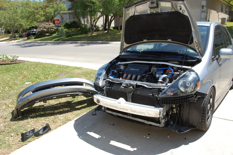

took off the bumper so i could remove the headlights

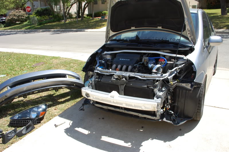

removed the headlights (after this start removing the fender lining.)

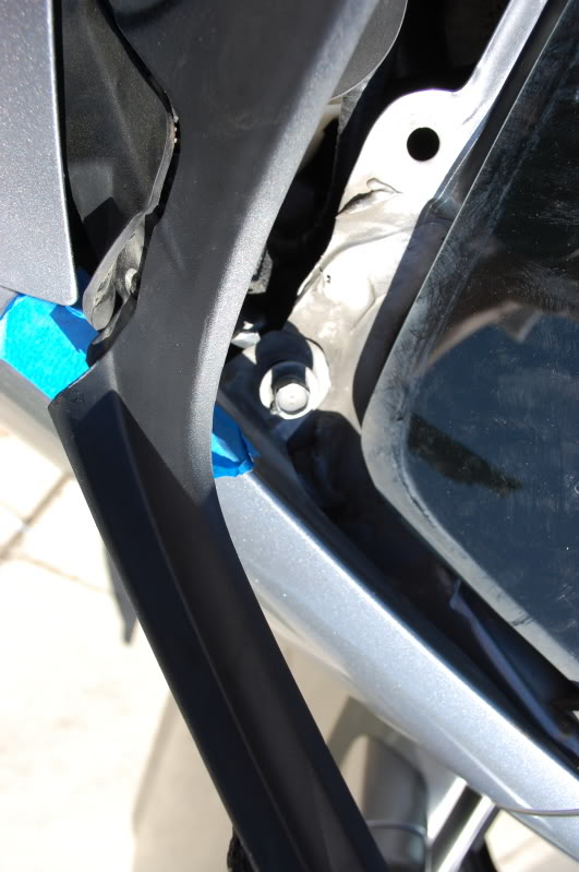

the hardest part of removing the fender is the bolt that sits under the plastic at the bottom of the windshield. ( ray told me about that one)
you have to tug on the plastic a little to pop off the clips that are holding it on

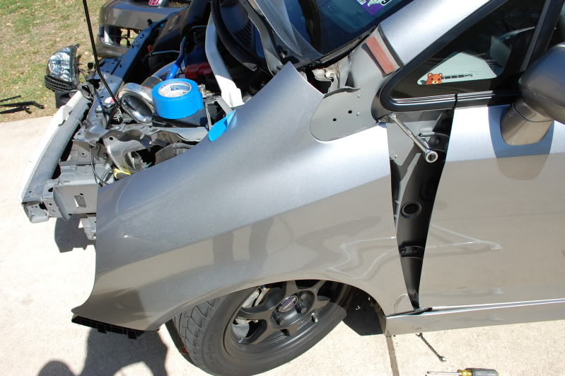

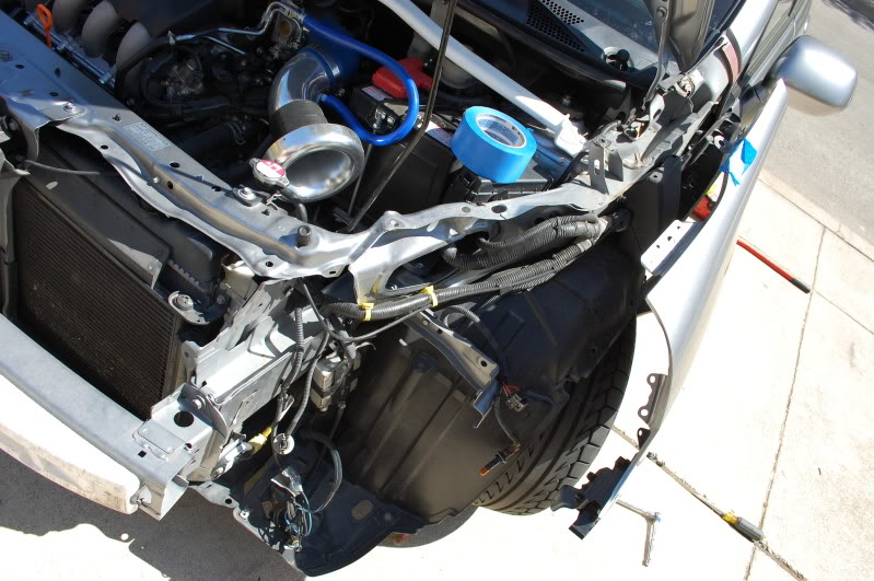

after you remove that bolt there is one underneath the sidskirt, headlight and a few in the engine bay

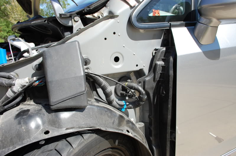

when i took off the fender there was this black box thing(have no clue what its for) it was getting in the way of where the fender brace mounts so i had to take it off.( also note the plastic cover that is sitting on the front of the door needs to come off too)

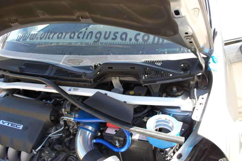

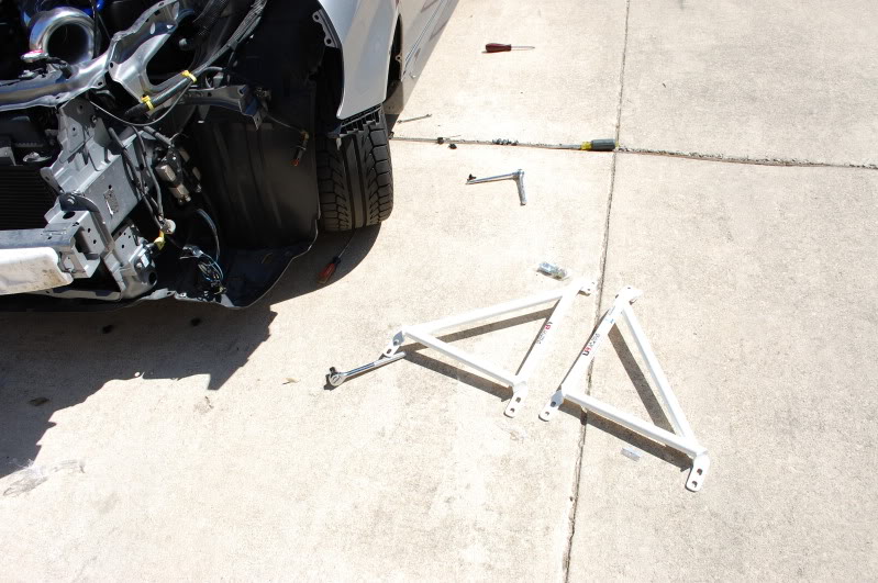

and these are the fender braces waiting to be put on

only problem i ran into was how to mount the front piece cause you cant get behind the frame to put in the nut. i will figure something out.

that front strut tower bar looks good. better than a lot i have seen so far
Old Apr 13, 2009 | 04:55 PM
redrumm's Avatar
iTrader: (21)
Posts: 4,534
From: wagovan
thanks. easy install too
