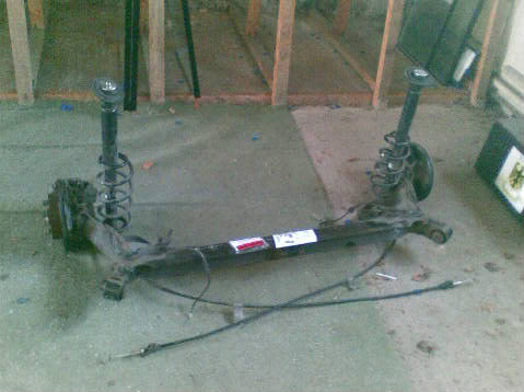

here's the complete axle as I got it

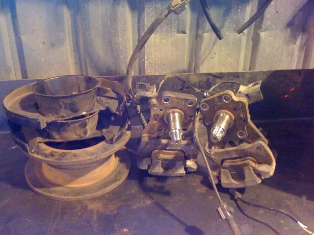

everything altogether

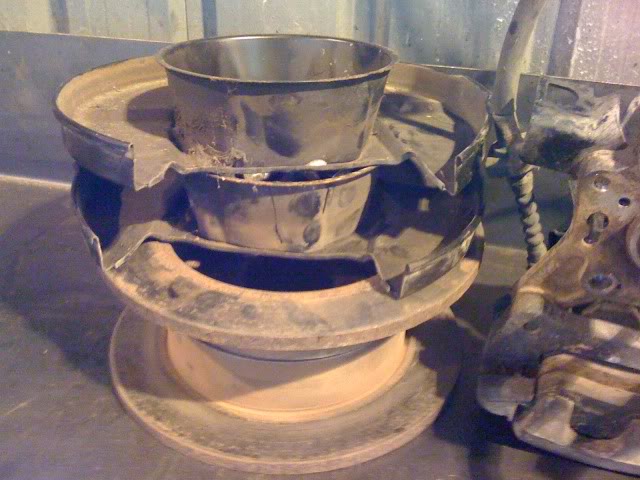

discs and covers

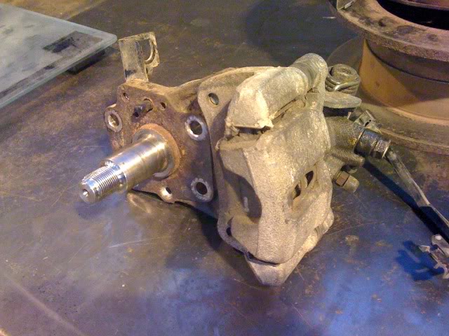

one caliper with spindle mounting

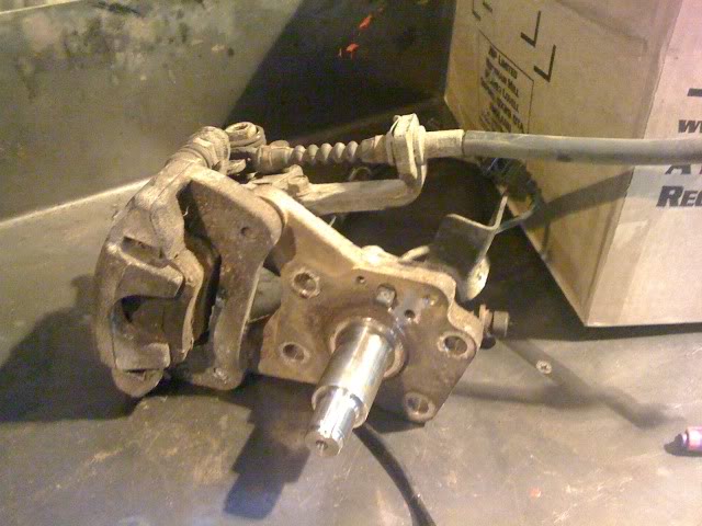

and the other
As I said they come with the brake cables attached and the abs sensor which just needs connecting to the existing ones (would have to cut the wire and reattach rather than reuse the existing ones as I guarantee you wouldn't get them off very easily!)
