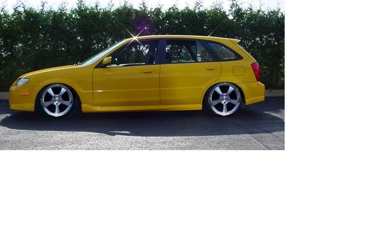

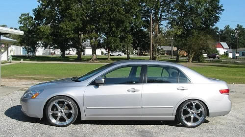

I had them on both of the vehicles below and loved them....nothing bad to saw....
1st of all they come with eibach springs which are great..stock stocks will wear down faster if dropped really low....but even blown stock shocks do not ride bad in my opinion with the ground controls.........also when installing, make sure you use the o rings between the coilover sleeve and the shock body....it will stop rattling or squeaking....and if they is some movement or play....go to local hardware store and buy a rubber type material to make the sleeve fit tight against the shock body....on my yellow mazda i used an old bicycle tire inner tube cut up and wrapped it around the shock body to take out any play..........shoot some pics after you get them.....
