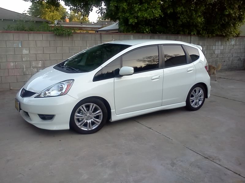

Yeah man, Jon (Twiz) kicked ass on this one, thanks so much broskie. Here is one cell phone pic, better ones to come:
