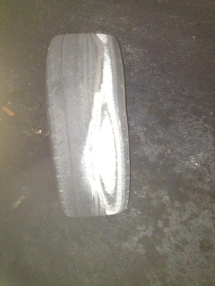

So guys this happened on the 27th.
I got a alignment and two new front tires and Im no longer hearing the strange sounds. THANKS for helping me out

haha funny enough i was wondering if there was an update to this thread today.. glad you got it solved !
you werent driving on tires with exposed threads were you? thats like superunsafe!

I like to live life on the edge hahah jk. Yeah I had to drive home from class like this. Needless to say it was the scariest 20 minutes of my life.
