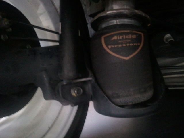

Old Jan 20, 2013 | 01:21 AM
  #69
mike410's Avatar
Posts: 620
From: Ft. Lauderdale, FL
Originally Posted by appleica
wow that's awesome so you can go that low. Are you on the bump stops?
side note, what kind of wind visors are those?
mike410> wait a min, is that your car with the koni's or your air bag system? that's way too low to drive normally...?
JDM Honda Access visors.
Don't think im on the bump stops as the tire is sitting on the wheel well. Koni shocks on the rear with the airsprings. Pretty much the same as a traditional setup, I can just adjust the height with air pressure.
Looks like this but now has the Konis
