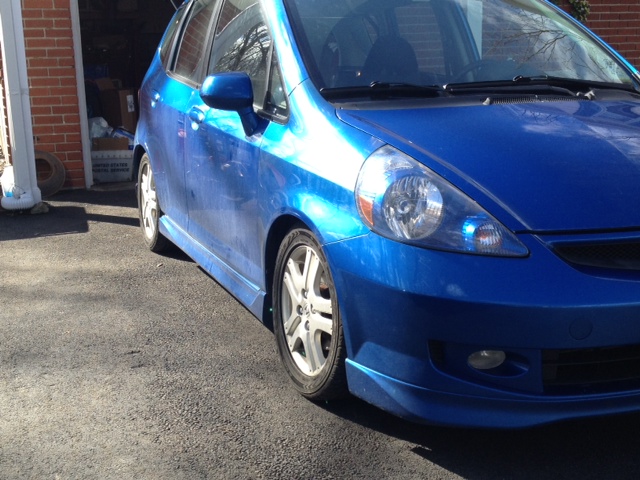

i think the spring rate is way too soft for these coilovers...then with the spring compressed-the car isnt lowered much---i went from the skunk2 pro-c which were awesome to this waste of a setup....i'm going to change the spring rate up front and hope it makes a difference-- if not ur see them post for sale--have maybe 3000 miles on them-- had over 80k on skunk2

i changed out the front springs and rides awesome..... i still have 1''and 1/2 more i can go down-- have it set on 4 clicks from the softest...
no rubbing or rolling of the fenders--- im putting my 17" back on this weekend..

went with H&R id spring at 450(8k) rate 6" spring... the spring that came with the coilovers are 8" think 335(6k)
i tried over and over contacting buddy club service to inquiry about there springs but no contact..!!
