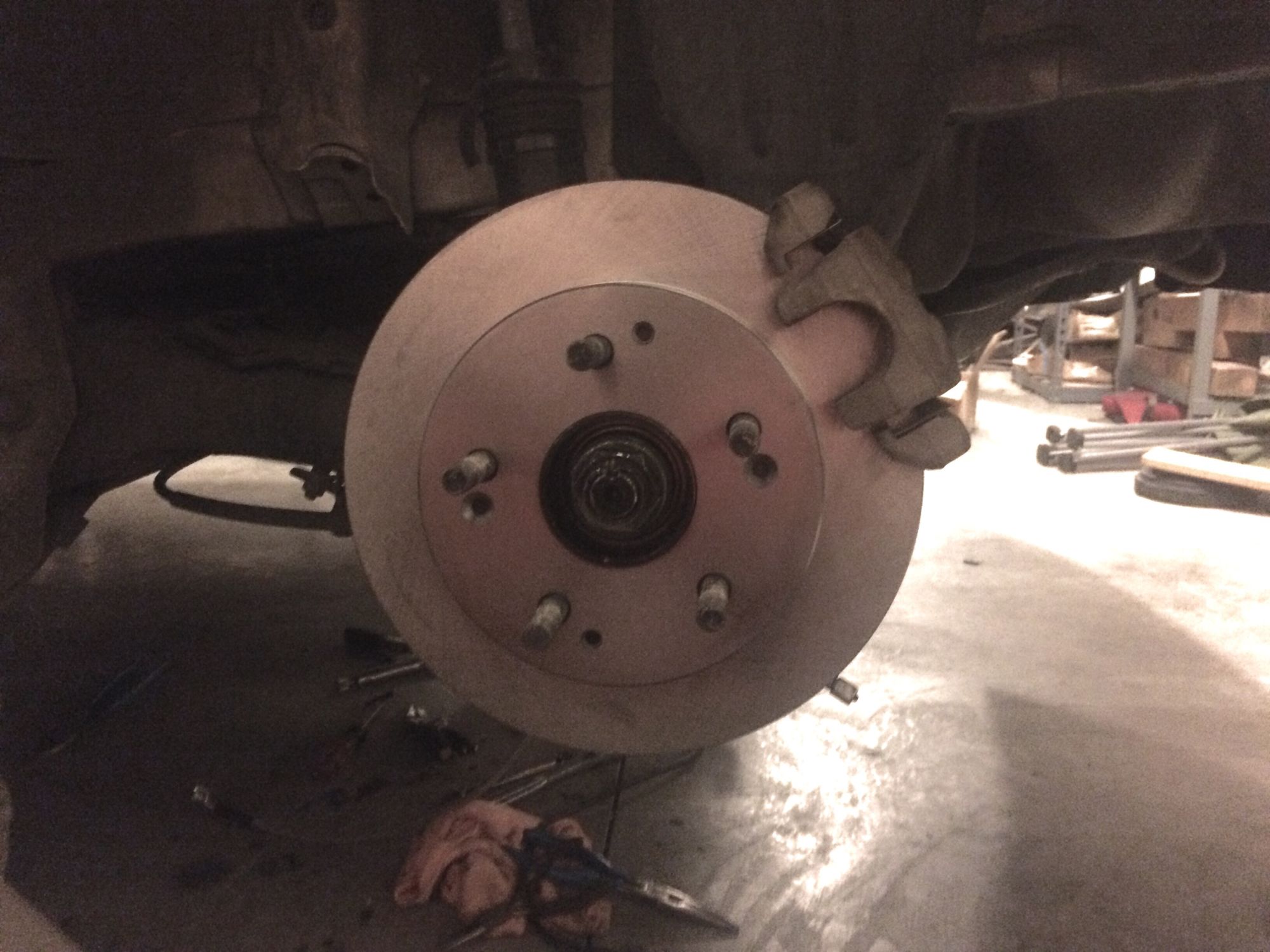

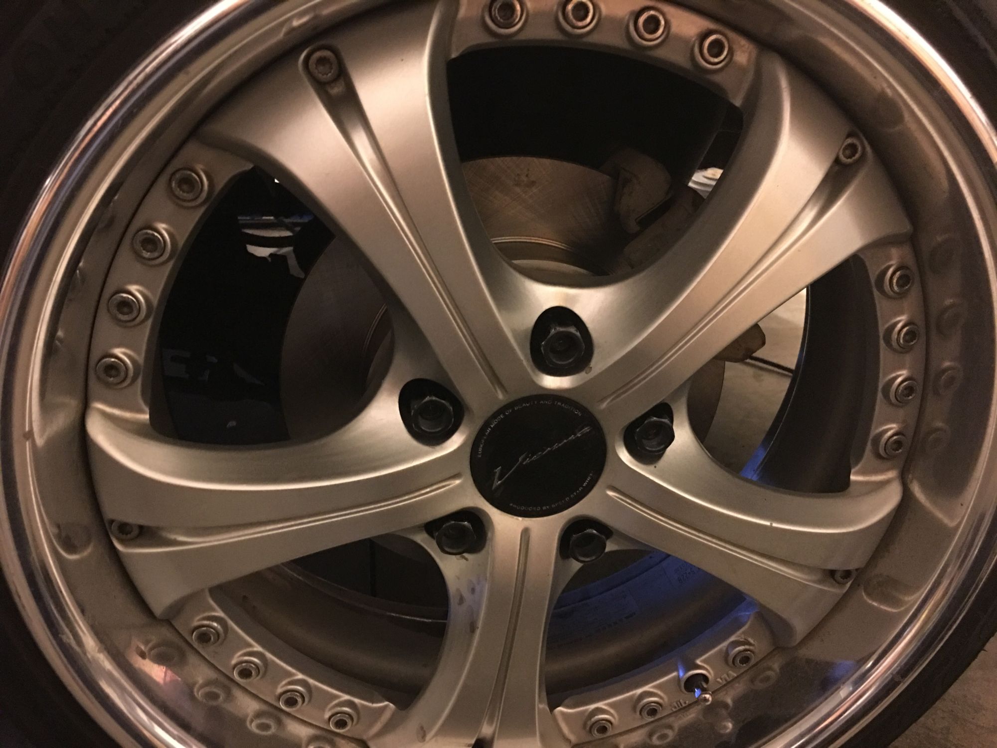

RSX rotors/calipers to mesh up with my 5 lug. Ebrake cable still needs to go on. 4 lug guys can do this upgrade also just use the early ep3 4 lug rotors... It's a super common upgrade for integras, so it made me want to try it to get an off the shelf rear brake parts with the 5 lug.

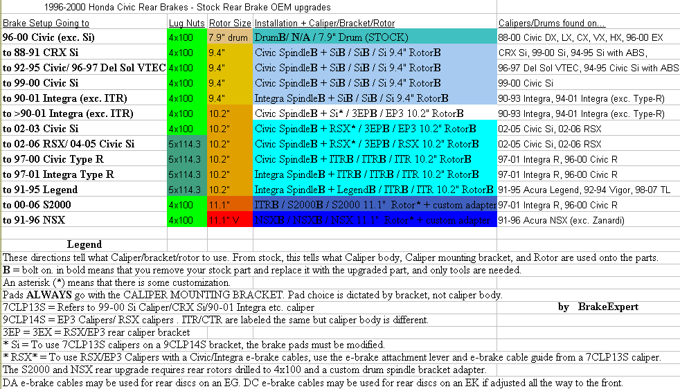

When I did a little bit of digging around with my conversion (I'm running the slightly larger EP3 SI rear discs), I learned that EP3 SI rotors are identical in size to the DC2R (10.2 inch rotors)... just different parking brake cable design for both the cable end AND the caliper (you WILL have to match the styles TO the caliper used).
Running EP3 may be an alternative that will allows you to achieve the same goal, just different parts. Unless of course you want to run LEGIT ITR spec brakes of course.
Here's a conversion chart listing various rear disc combinations using Honda/Acura specific parts.
Attached Thumbnails DIY: GD Rear Disc Brake Conversion-80-rearbrakeupgradeschartml5_1_d840faf1cf21ac3a594c057331f1f65fcfb311a8.gif

Thanks for the quick response!! Hootie, I'll be PM'ing you for more info on the EP3 conversion if you don't mind.
