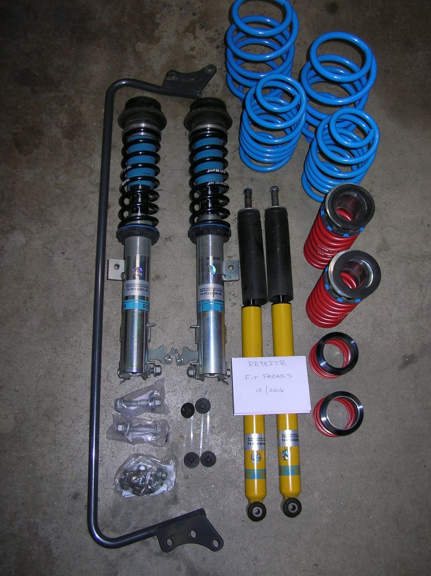

My first change was to add a Progress rear sway bar which made no perceptible difference in the car at all. I read on forums that it makes for dramatic change but I think those are the comments of people with dramatic imaginations. I then changed the dampers to Bilstein and made up some spring hats so I could run spring rates of my choice. I doubled the front spring rate and tripled the rear and it's still so benign at/beyond the limit that I giggle. Those rates are pretty tolerable for daily driver duty and they seem to be decently compatible with the Bilstein damping on both street and track. They feel like they’ve got pretty linear curves – they could be better on curbs but they’re ok. Between the curves and the rates they are pretty harsh over square edged stuff on the street and the bigger the worse. I also ran eccentric camber bolts – just one per side on the bottom hole. The upright casting was too close to the Bilstein body at the top hole to get any more negative camber with a second eccentric bolt there. IF you play on the track with the stock Fit dampers you should probably try extra hard to keep off the curbs and gators - I'm pretty sure I damaged a shim or otherwise broke the stack in one of my stock struts that way. The way they're making gators these days is almost criminal - they break wheels, rip up the bottom of the car, and damage parts - might as well go back to half-burying tires at the apex as safety is apparently not the concern anymore. Also, the stock dampers top out with pretty good clunks so it's not a rally car as it comes.

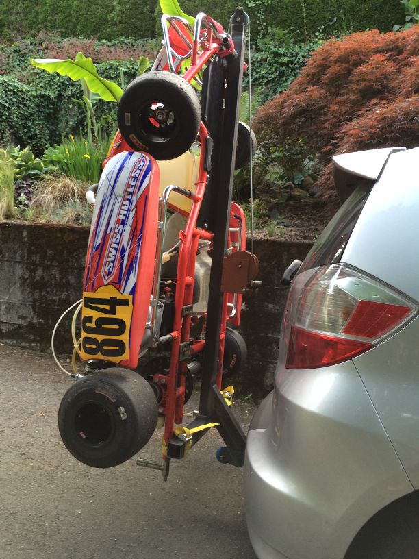

With regard to the trailer hitch – I thought the best one for my purposes was Torklift’s. It mounts by sandwiching under the bumper rebar, and it’s got a longitudinal brace that carries forward to the jacking point. The rating is max 200lb tongue weight, but in my experience (admittedly a little beyond that number AND cantilevered a foot) that’s too much to ask of the sheet metal structure. My loaded kart rack eventually ripped the jackpad off the supporting members. I resolved that by running a tie strap from the top of the kart rack mast thru the rear passenger windows.

Tech details:
Front springs: H&R 250-60-030 (250mm length, 60mm ID, 30n/mm rate) – installed spring height 8-3/8 inches gives approx stock ride height.
Rear springs: H&R 200-050 (200mm length, 60mm ID, 50n/mm rate)
Rear helpers: H&R ZF080-005 (80mm length, 60mm ID, 5n/mm rate)
