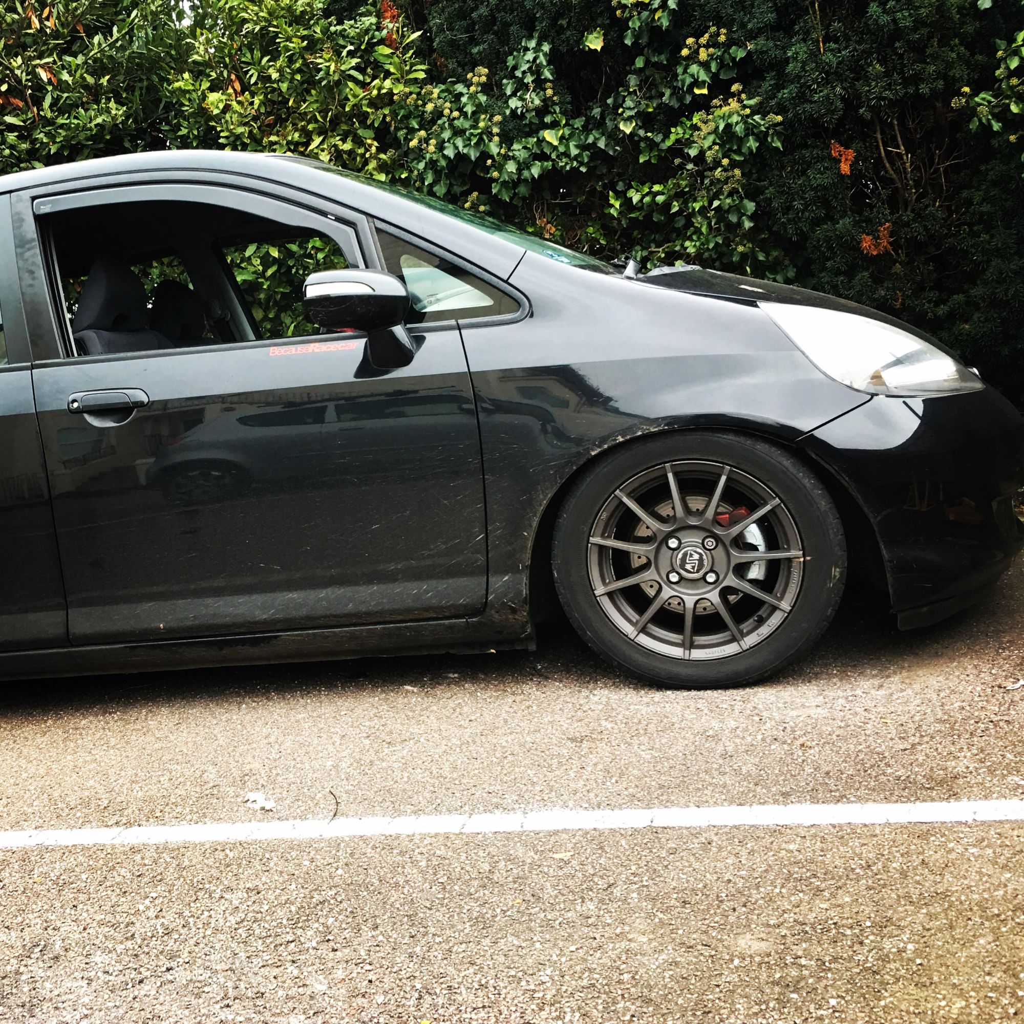

So recently I purchased a set of BC Racing Coilovers (BC Racing - Not BuidgClub) for my UK Honda Jazz (2007).
They took about 6 hours to fit in the pouring British rain with just hand tools and WD-40.
The result is as follows:
Front:
The Coilovers still have an inch or so lower in which they could go.

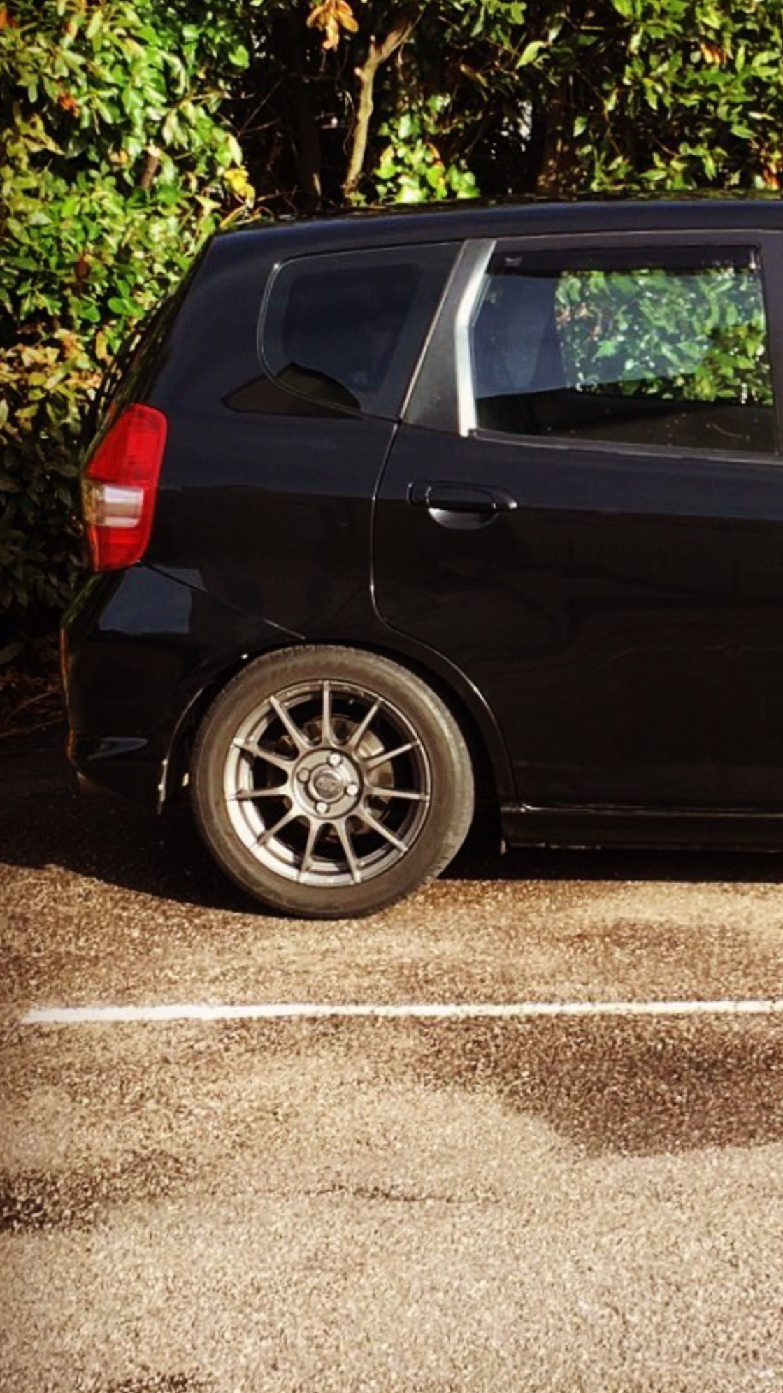

Rear:
The rear can go much lower, I haven't actually changed it from how it came.
They were £640 and took about 3 weeks to arrive - but they were well worth the wait and most certainly feel well made and of really good quality. If anyone is wanting to get Coilovers and wants to try a lesser seen set on the scene. These are certainly the ones.

BC makes a decent coilover. If you're looking to increase the ride handling abilities then go with some Swift springs and change your rates (stiffer). The car is sitting a bit low for what I can tell. Be careful on the height because to low is terrible on the Fit's geometry. If I had to guess I would say your control arms are at a negative angle.
