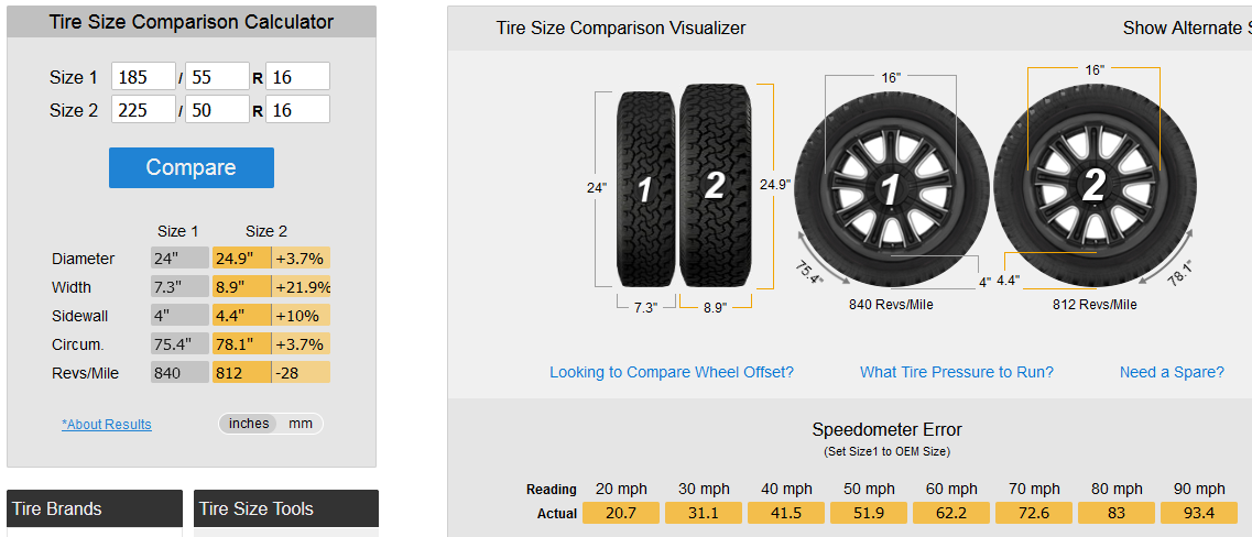

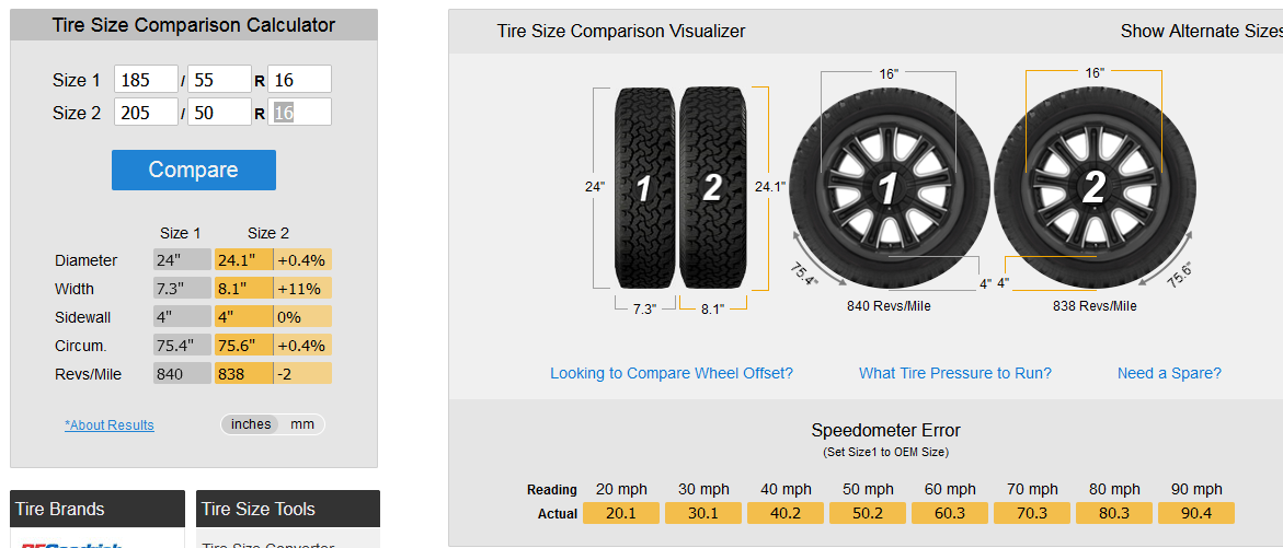

205/50R16 is almost identical in diameter to the stock 185/55R16, which is why it's a popular upgrade for people who want a fat(ter) tire without additional modifications.
225/50R16 is a bit taller and way wider than stock.
I don't know what wheels and tires you're currently running, but the comparison with stock is something like this. Will it fit without rubbing? I'm not sure, but I wouldn't want to pay for a new set of wheels and tires to find out.

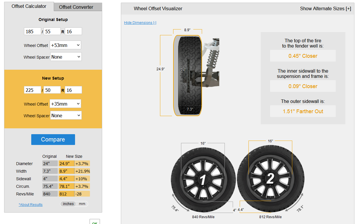

You will never fit a 225/50 +35 on there. Especially with stock suspension.
Since you are all stock you are much better off using the stock wheels as well. Even going with a 8" wide wheel on a stock fit is just crazy.
