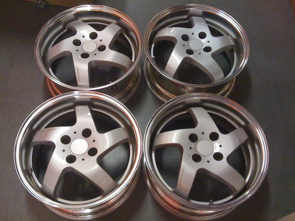

so im thinking of buying these wheels for the Fit.
they are 15x6.5 +34 offset.
if that offset to low for the Fit?
will they rub when i turn?
or am i ok since they are 15x6.5?
i plan on lowering it with skunk2 springs.
heres a pic (looks like a Stark 1 face w/ a RC Stark lip)

Originally Posted by jedimindtricks
can anyone help me?
offset way too low. need 42 mm mimimum if don't lower, 45 mm if you do, and using 205 tires.
Old Aug 8, 2008 | 04:48 PM
MNfit's Avatar
Posts: 3,380
Yea the offset is low, but just because its lower then 45 doesnt mean you cant do it. I realy hope some of the more experienced people that have run lower offsets chime in. I have run 15X6.5 with a +38 offset for about a week with no problems. I would suggest running a 195 tire and you would may have to do a bit of pulling or trimming on the fenders if lowered
