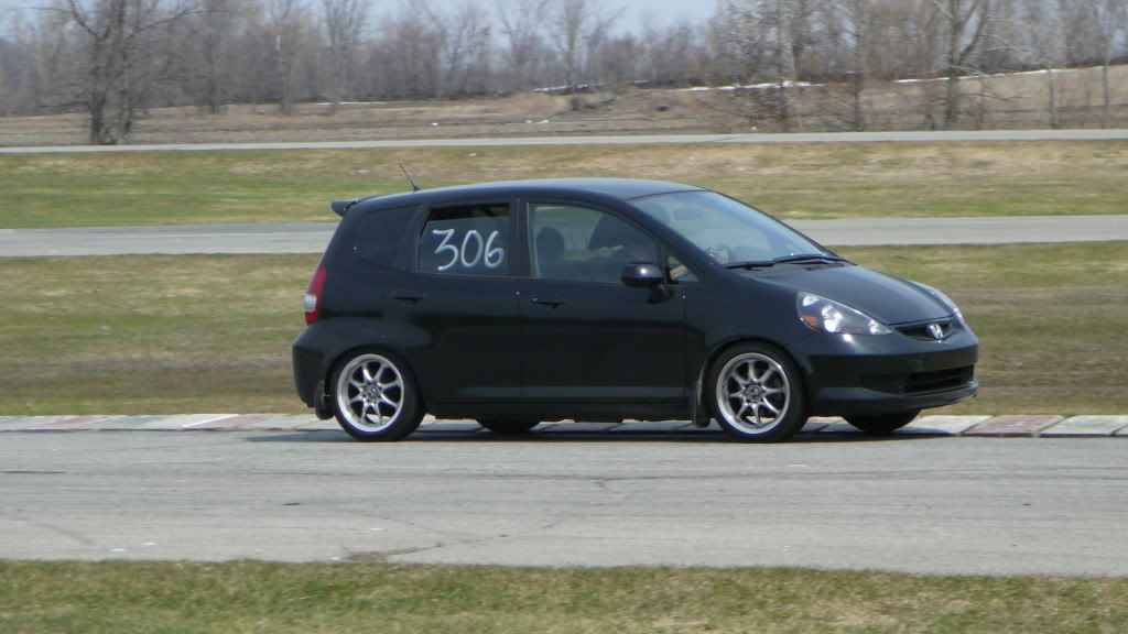

I used 16x7 +40 wheels with 205-45-16 falken ziex 512 tires last summer on the track (stock suspension) and yes it rubbed but really only for the first few corners...I lost 2 small plastic clips on the passenger side and I was OK after that !! It only touched when the front suspension was bottoming out. On the street nothing ever touched even with 5 people in the car!
For this summer I have some new 205-40-16 falken rt-615 and eibach pro-kit springs (not installed yet). Since the diameter is quite smaller I should be ok. Can't wait to try this new setup on the track!

Good to know, I have heard of Falken's being better than other tires when it comes to clearances. Even going from a 45 to a 40 series will give you a bit more clearance, especially if you are right on the threshold.
One thing I think people overlook is while a "touch" around the city might not be a big deal, it will distroy things quickly on the track.
lol, I know the feeling I was thrilled when my setup finally stopped rubbing
