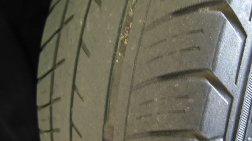

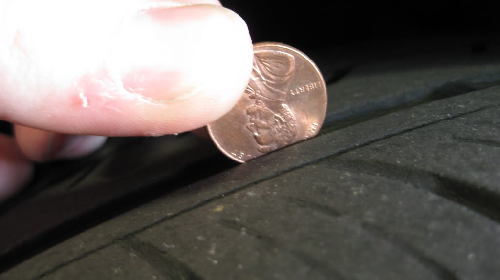

heres what i have, i did the penny thing and i can see lincolns head so does that mean i need to change them

judging from your pics, it's about time to change your tires. do you see that wear bar near the bottom of your pics? it's in the circumferential groove in the tire tread. that wear bar indicates that you're getting near the end of the tread's intended life. you can look up "wear bar" online if you aren't that familiar with tires yet. but basically, it's almost exposed, and it's intended to be used as an indicator of when your tread has worn down to the point that you need to get new tires.

Ok well it looks like i need tires. Thats ok bec i want wider ones anyway. Better handling here i come
