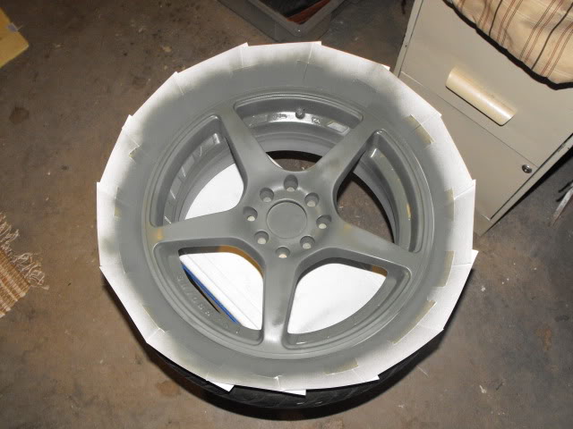

def. didnt spend $170. Got wheel paint from autozone and clear coat. Your gonna go through a lot of prep stuff like stripper, sand paper and stuff to clean the wheel. Just remember to take your time, dont rush the prep, and nice even light coats.

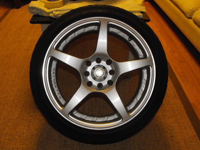

Wheel before anything.

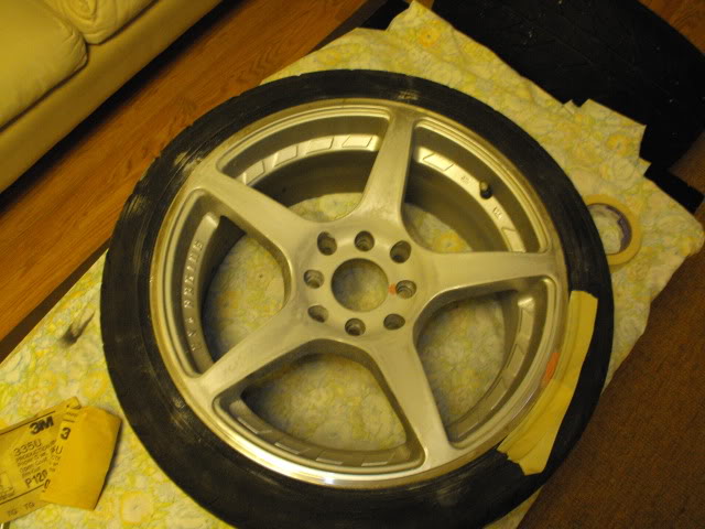

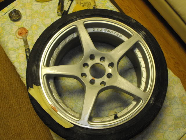

filling in holes with bondo and sanding

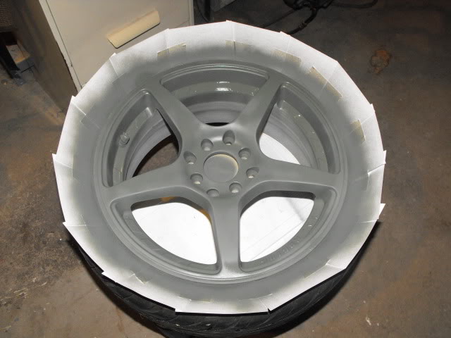

primer

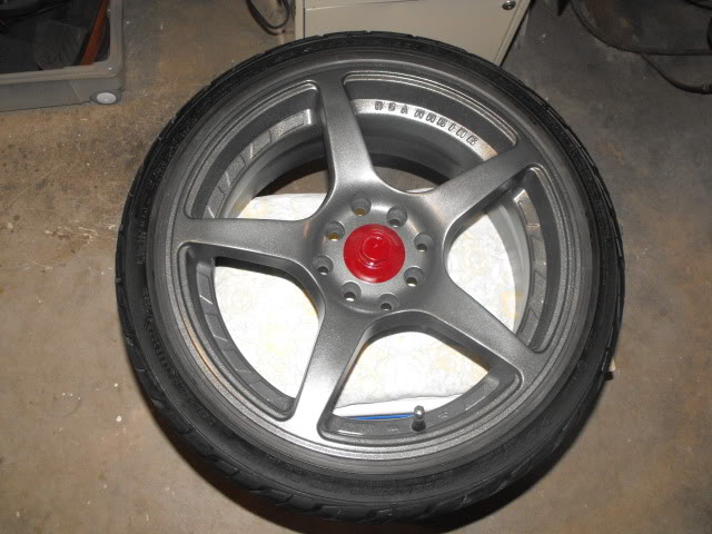

final product
ended up not using the centercaps
