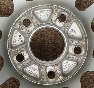

As for telling if they're real. I've had two different sets in my possession. Here's some pics of them that might help you tell if it's real
Here you can see stamps on the inside with tons of information. The second set had the offset stamped on a little raised area, like a plaque. Either way, on both sets it was a little hard to read the offset, so perhaps the seller is mistaking the 2 in 42 as a 1, which then makes the 15x7 +41 very plausible that it's authentic wheels.

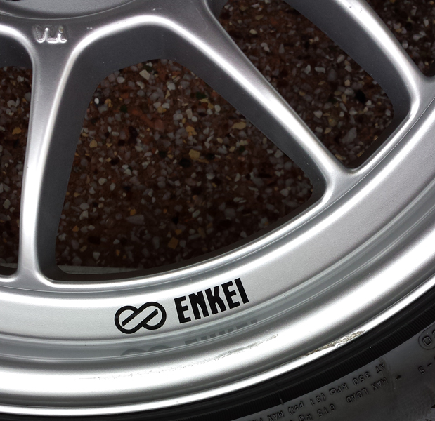

The "enkei" is just a sticker, but there is another stamp by the lug nuts
