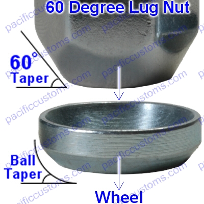

yeah, no problems until BANG! you have a problem... hopefully i am not on the same road as you when this happens. i watched this happen at the track to a guy that was running tuner lugnuts on stock wheels.
seriously, just because you haven't had an issue, doesn't mean it is right. skunk lugnuts are 60 degree taper and honda wheels have ball seats, so your lugnuts are only touching 1/3rd the area they should be, thus putting stress on the wheels and lugnuts themselves.
if you HAVE to run tapered lugnuts on oem honda ballset rims (for the look...), you should be using these washer/adapters:
http://www.pacificcustoms.com/mm5/me...ct_Code=WHL005
