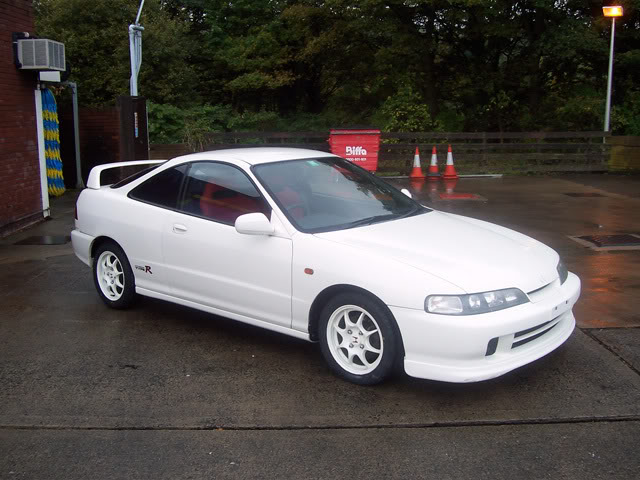

Yes these are the wheels;
Thanks!
I'll take a look at my local auto-supermarket for them!
I think the OEM Integra Type R wheels are 4x114.3, whereas the Fit/Jazz is 4x100. If that's the case, then they won't fit. Just a heads up.

Old May 23, 2013 | 03:26 PM
Wanderer.'s Avatar
Posts: 4,363
From: Hayward, CA
No, it depends on the rims. Most OEM rims are ball seat, most aftermarket rims are conical seat.
Yes to both of these. You'd need a 4x114.3 to 4x100 adapter or would need to change the hubs with something that was 4x114.3 that will work, what hub would work on the Fit I haven't the slightest clue.
Old May 23, 2013 | 07:59 PM
236GFX's Avatar
Joined: May 2013
Posts: 29
From: UK
Ok well that saves me the trouble of driving 30mins to take off one wheel to discover they are the wrong fitment!
I'll take a look for 4x100 Honda wheels at my local scrap yard
