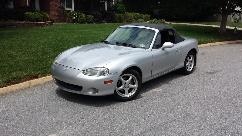

Here is a photo of what i had in mind. I hope the GK looks good on them. I'm going to have to paint them anyway, so what sort of color do you guys think would look good with yellow?
