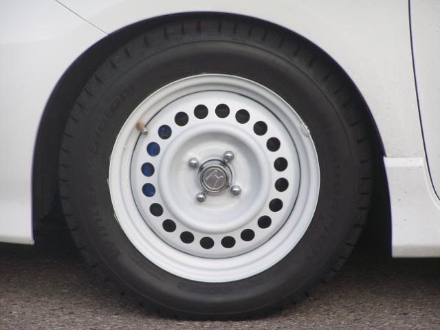

FYI, I have a 2010 Fit Sport and just picked up a set for 2004 Honda Civic steelies with 185-70 R14 Blizzacks...fit is perfect. Overally diameter is extremely close, width is exact...to the Fit Sport's stock tire. Certainly not the coolest looking but should do the trick for winter.
Old Nov 25, 2010 | 06:08 AM
  #319
Black3sr's Avatar
Posts: 4,250
From: Kitchener,Ont Canada
Paint them to match and an old set of Civic center caps works for me.

ooohhh...I like the civic center caps, the search is on .
