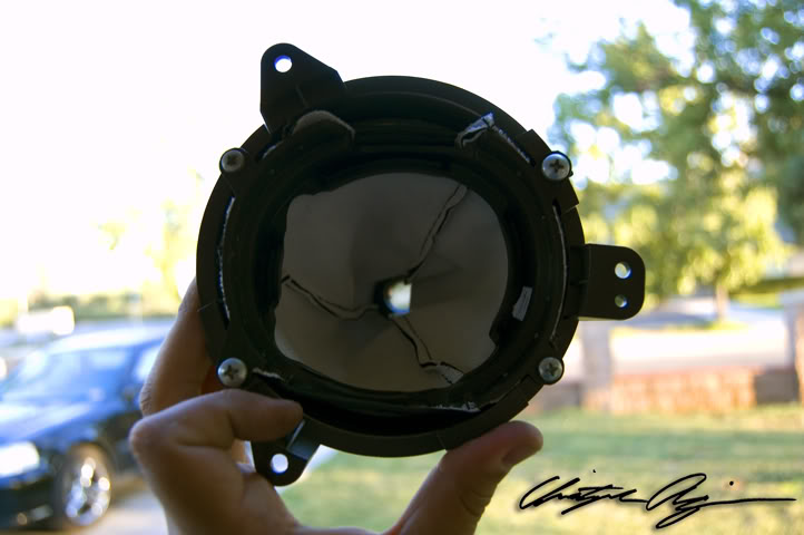

Flip console over and remove the 3 screws to free the center ring.

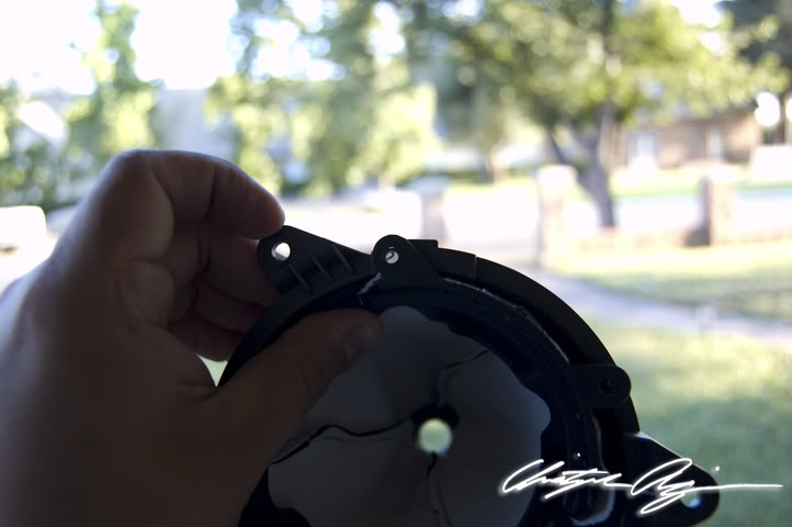

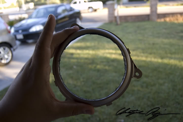

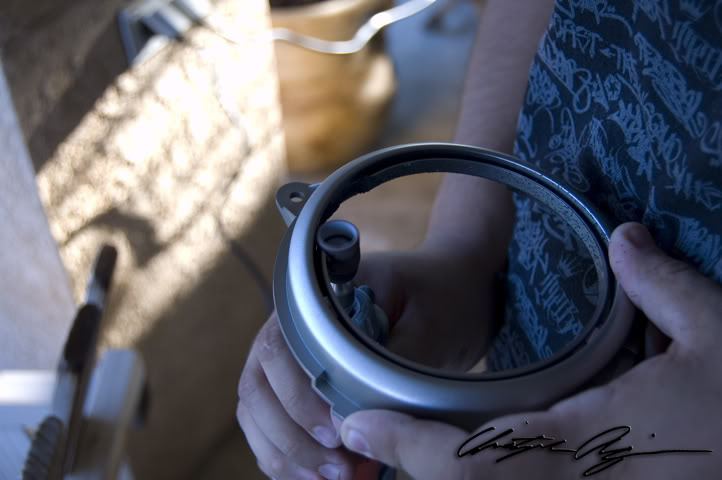

Dremel out the inner ring

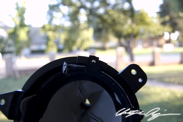

Mock up the Shift boot and drill your new holes to screw it on.
Step 5.
Screw it in.

whats the reason for drilling out the inner ring?
Old Aug 17, 2008 | 08:26 PM
dagul's Avatar
Posts: 387
From: VA Beach
Looks like the boot won't sit flush with the outer ring if you don't dremel the inner ring.

yes, the inner ring comes out or you will have a gap.

the inner ring must come out for it to look clean.
