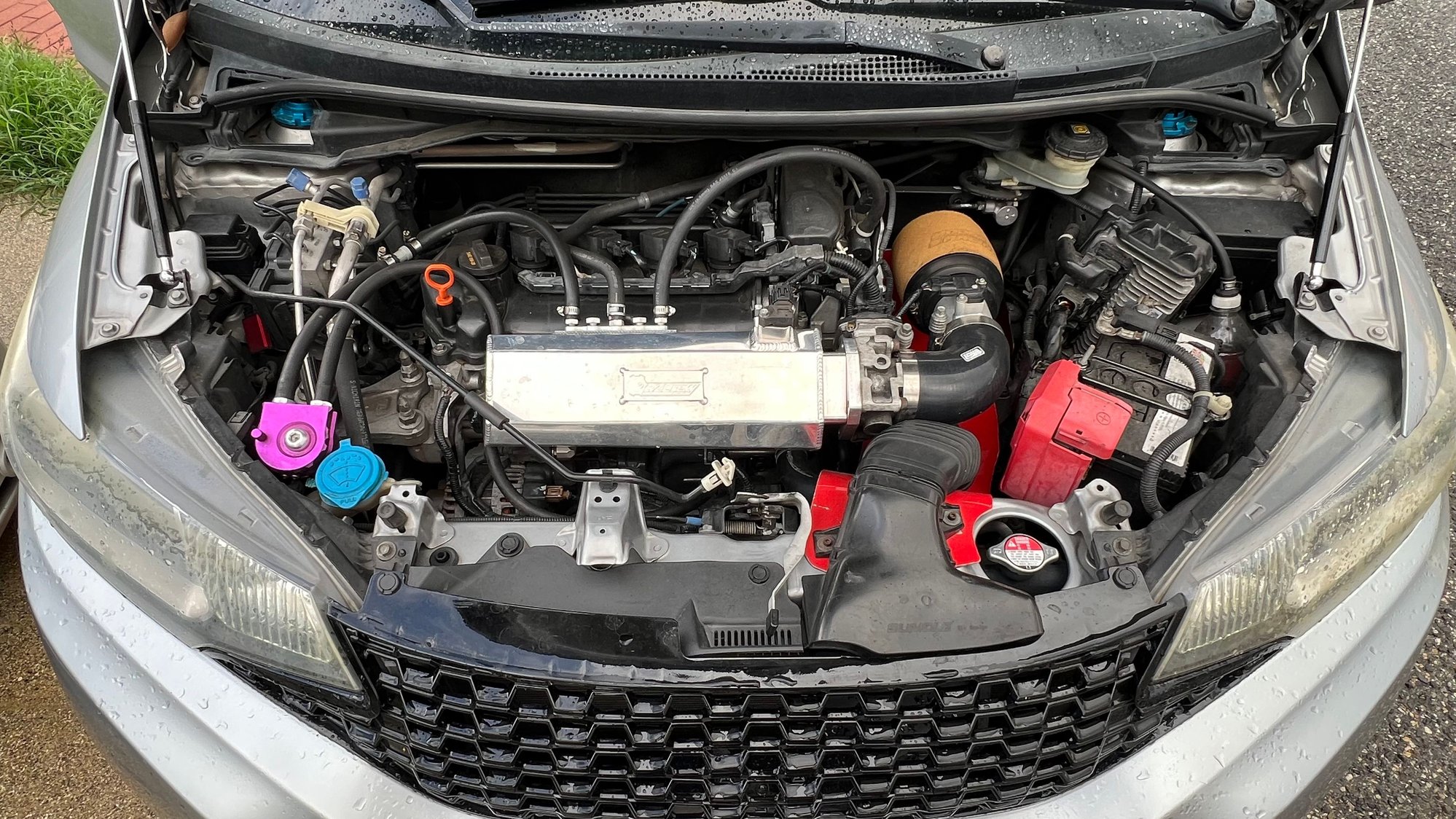

As stated…. We will need mire details on the kit you bought….. i went the “cheap” route too but i tried to replicate positioning and sizing from the MAF up to the throttle….
i bought a 63mm aluminium MAF adapter and a 90degree 63mm to 70mm silicone elbow (The 70mm side going to the honda CR-V throttle body)
and haven’t had any issues with the setup
