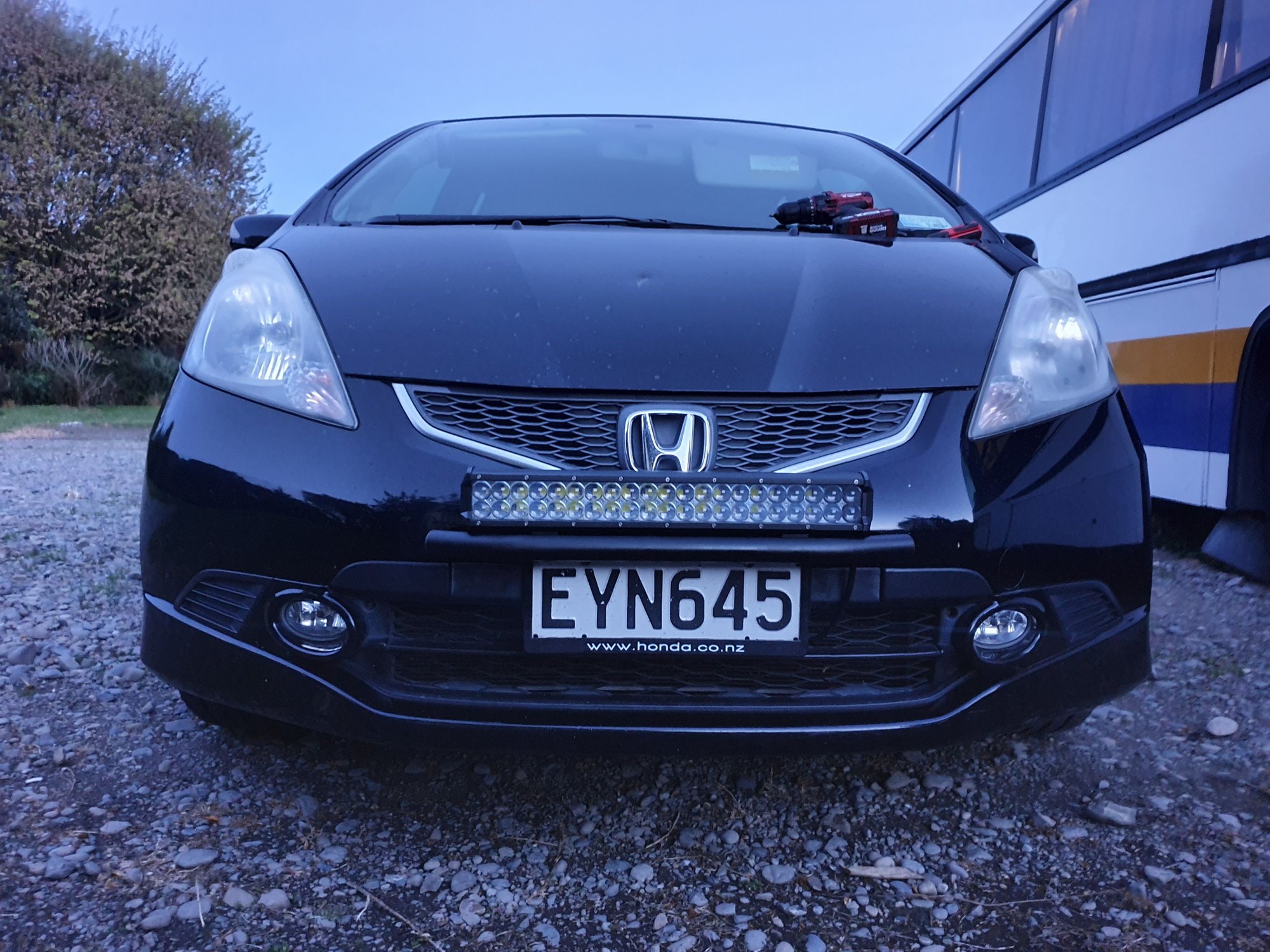

Today after work I mounted the LED lightbar properly to the front of our Jazz, as I want it to come on with the high beam I ran the relay "trigger" to the LHS high beam terminal...
Now, the lightbar functioned great and came on with the high beam but now the driving / fog light on the same side appears to have blown?
I'll be the first to admit that anything over wiring up a car stereo is not my strength, but this should have been simple.
Any suggestions?

For one thing... you're not mentioning how you wired it up.
If it isn't already, try finding the wire that ONLY becomes live when high beam is ON. Cut it and put the trigger wires from the relay in between. That way, power will ONLY flow through one, and then the other.
If you try any other way (like one wire to the common and another wire to the other side of the filament), you risk a short.
Another option is to forget about the headlights and just install a switch in the car to trigger the relay.
