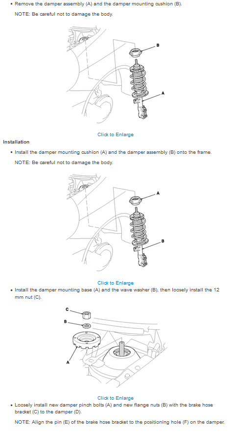

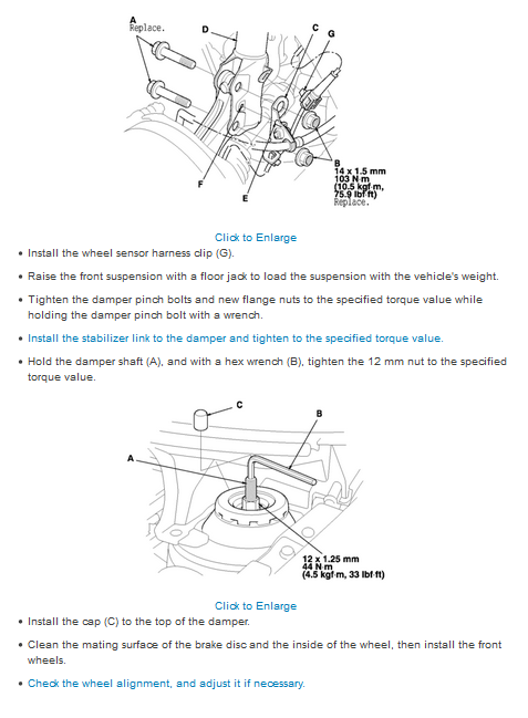

Chilton mentions to replace nuts/bolts. I dont see any recommendation to replace bearing

I think they do mention to "check" for deformation / weakness / damage / etc
